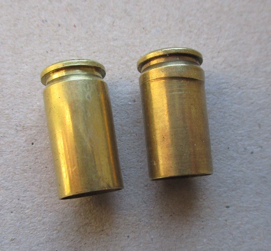

Look at the primers in a cartridge that has blown a cylinder wide open and maybe the top strap off a revolver. More often than not they look normal.
I was more concerned about the case being partially unsupported at the feed ramp. I have seen cases blown down through the magazine well. Makes the magazines come out of the gun really fast! :-)
But there is no swelling of the fired cases. The heavy load is a standard load in some loading manuals I have.
Here's a normal 9mm compared to an overloaded one ... it did not blow but came close.
