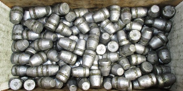

Friend John Killebrew sent me some bullets awhile back ....
by JimT, Texas, Tuesday, August 01, 2023, 12:19 (1046 days ago)

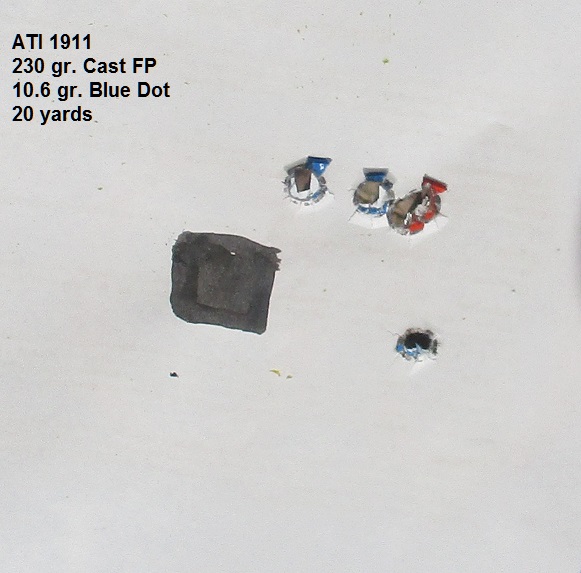

and I have been playing with them from time to time. Got out to the Range today and ran some through a couple 1911's.

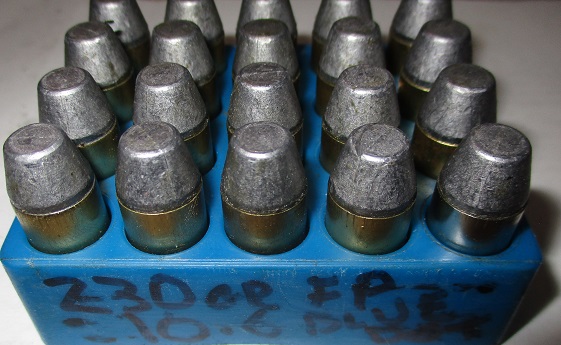

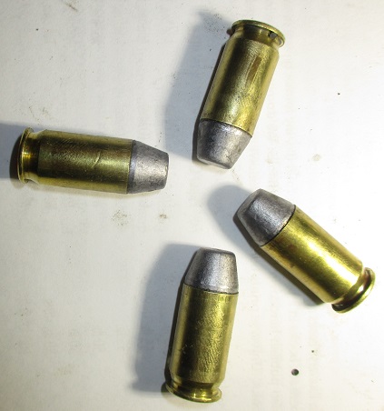

230 gr. cast .45 ACP Bullets

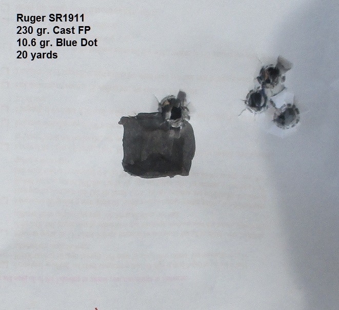

I used my old ATI 1911 and the Shootists Ruger SR1911 with 2 different powder charges ..
9.0 gr. Blue Dot and 10.6 gr. Blue Dot. The 10.6 gr. load is stout and makes the old 1911 recoil a bit. Out of my ATI they average 1034 fps.

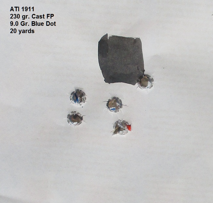

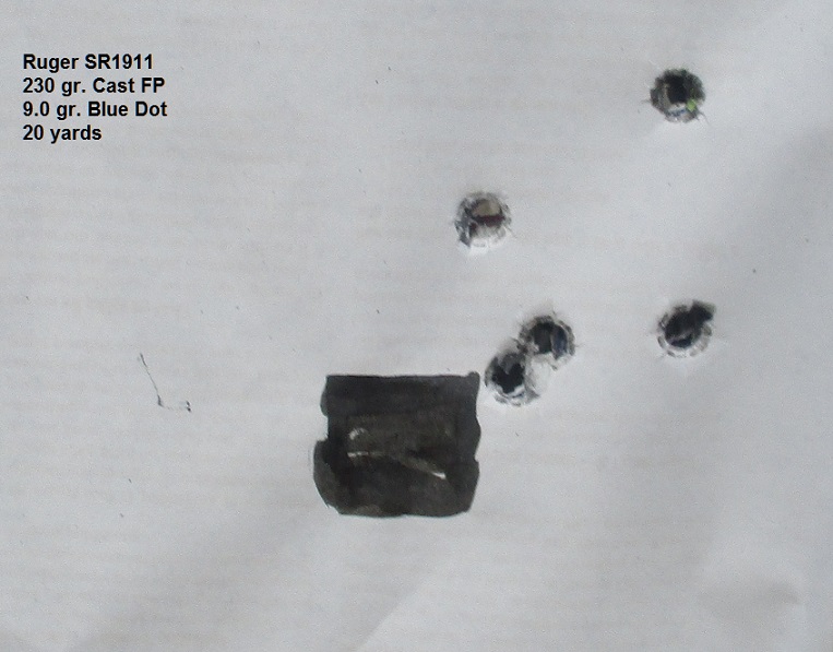

I fired several groups with each load and each gun ... these targets are about average.
ATI
RUGER
