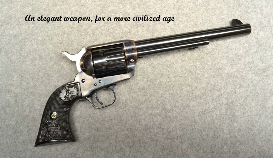

An elegant weapon, for a more civilized age.
