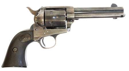

In 1873 Colt introduced the Single Action Army (also known as the "Model P") along with the .45 Colt cartridge. It was the military caliber for 17 years and like most military calibers that worked well in combat, it became popular with civilians. That it has remained a favorite so long after more "modern" cartridges have been introduced is a testimony to its effectiveness. Now more than 150 years old it is still one of the best.

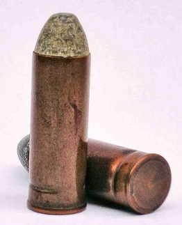

![[image]](images/uploaded/202609141410316aa80057498b0.jpg)
Original .45 Colt copper case inside-primed
