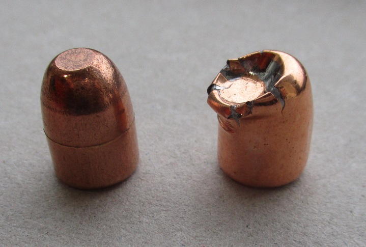

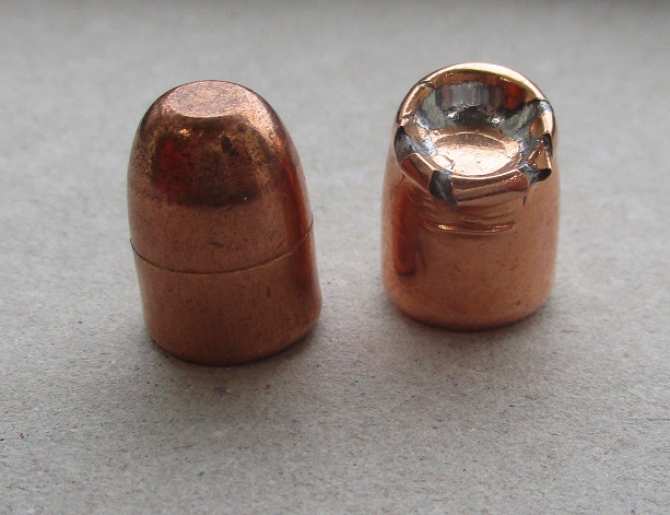

I was wondering how the plated .45 ACP bullets compare to the jacketed bullets. So I took a couple factory jacketed bullets and a couple of the plated bullets and put them nose to nose in my vise, then slowly closed it.
The harder bullet will always show up. Before a got a lead hardness tester I tested my cast bullets this way.

That’s a good way to do a comparison.
I e shot a decent number of plated bullets. It’s my understanding that they are swaged and then plated, so not very hard and the plating allows for higher velocity than bare, soft lead. Kind of like powder coating, you can use softer alloy and still be able to drive it harder.

The plated bullets will not penetrate like the jacketed bullets. Even though plated, they are soft and deform easily. My preference is to punch a hole in and out.
