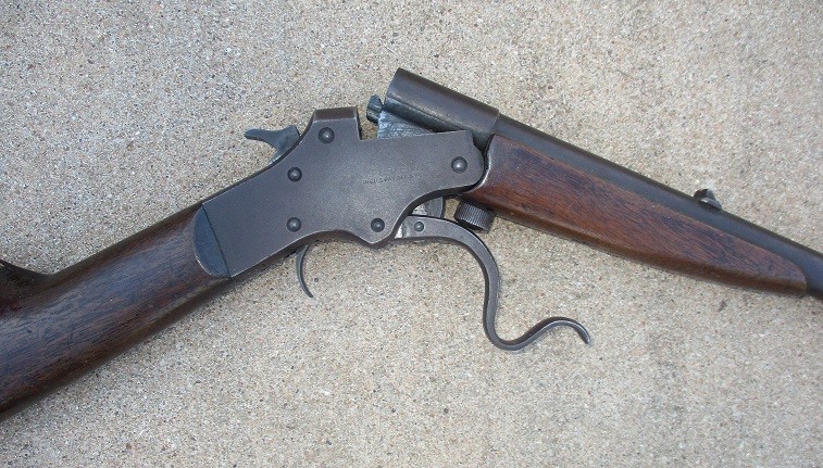

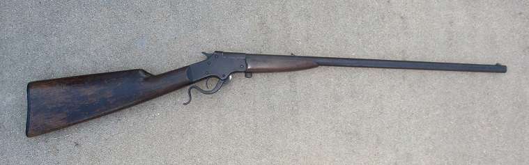

Arizona Fish and Game had authorized the .22 Magnum in a rifle for Javelina and that was what I needed. Looking around I had an old Stevens Marksman .22 rifle. It is the break open single shot that Stevens had made.
The barrel on the one I had was no good, but, the Marksman is a take-down! And I had a perfectly fine Mossberg barrel in .22 Long Rifle. All I had to do was rechamber the Mossberg barrel to .22 Magnum and turn it down to where it would fit the Stevens. The action was plenty strong for the .22 Magnum.
I worked on it and got it done. I did not have a .22 Magnum chambering reamer but I improvised. I used a drill bit a few thousands smaller than the .22 Magnum cartridge. Then, using a fired .22 Magnum cartridge on a home-made shaft, I polished out the chamber with my electric drill, valve grinding compound on the cartridge. It was slow but it worked very nicely. I fitted the barrel to the Stevens, got the sights lined up and sighted it in. Then my daughter started practicing with it.

The Marksman is stronger than the Favorite.
by JimT, Texas, Saturday, July 18, 2026, 18:03 (113 days ago) @ Paul
I have bent the screw that the falling block rotated on in the Favorite with modern high velocity Long Rifle ammo. I would not convert one to .22 Magnum. The Marksman held up just fine. Looking at the action you can tell why.
by Paul ⌂, Sunday, July 19, 2026, 20:00 (111 days ago) @ JimT
Now that's interesting. Never had a problem with the family Favorite, so far. But that's good to know. And yes, that Marksman is definitely stronger than the Favorite setup. Haven't seen one in a coon's age, though. Either of them, for that matter.

Very cool! Did it take a lot of work to fit eh barrel to that action? Like Paul, I wasn’t familiar with the break open action but have seen many falling block Favorites over the years.
No. It was a very easy conversion.
by JimT, Texas, Sunday, July 19, 2026, 18:53 (112 days ago) @ Slow Hand
I just had to turn the breech end of the barrel down to fit into the receiver. It had to be the correct diameter and length so the headspacing was correct.
EDIT .. I had to cut a slot in the right place on the bottom of the barrel so the extractor would lift the cartridge out of the chamber.
