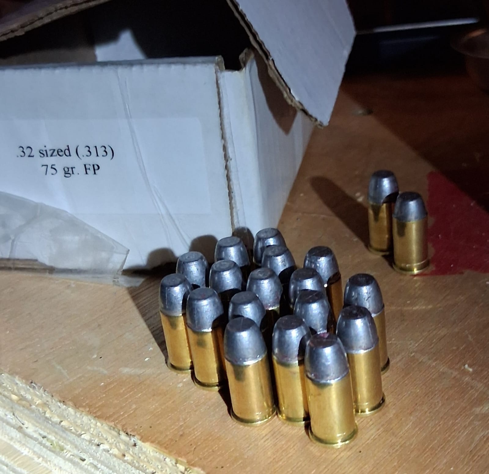

I'll be stateside for a few weeks. Yesterday I managed to find some time to use some brass Mic sent me. Only needed a box or so, have enough for a lifetime supply of Saturday Night Special loads... got a box worth loaded yesterday. These dinky little cases are entertaining, sort of. 75 gr RNF over a pinch of HP-38. Need to get busy and load more practical stuff.
.32 S&W Short?

Those sure are cute.

by Paul ⌂, Wednesday, May 27, 2026, 20:46 (166 days ago) @ Otony
Yes indeed. Working with original 32 S&W beats trimming down 32 S&WL brass or using 32 ACP for mock 32 short loads. :-D Now to find time to try them out for function.
