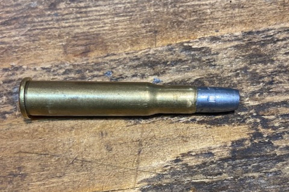

The above is what the 2.51 OAL cartridge looked like after being cycled through the '94. Note the rifling marks on the bore-rider section of the bullet nose.

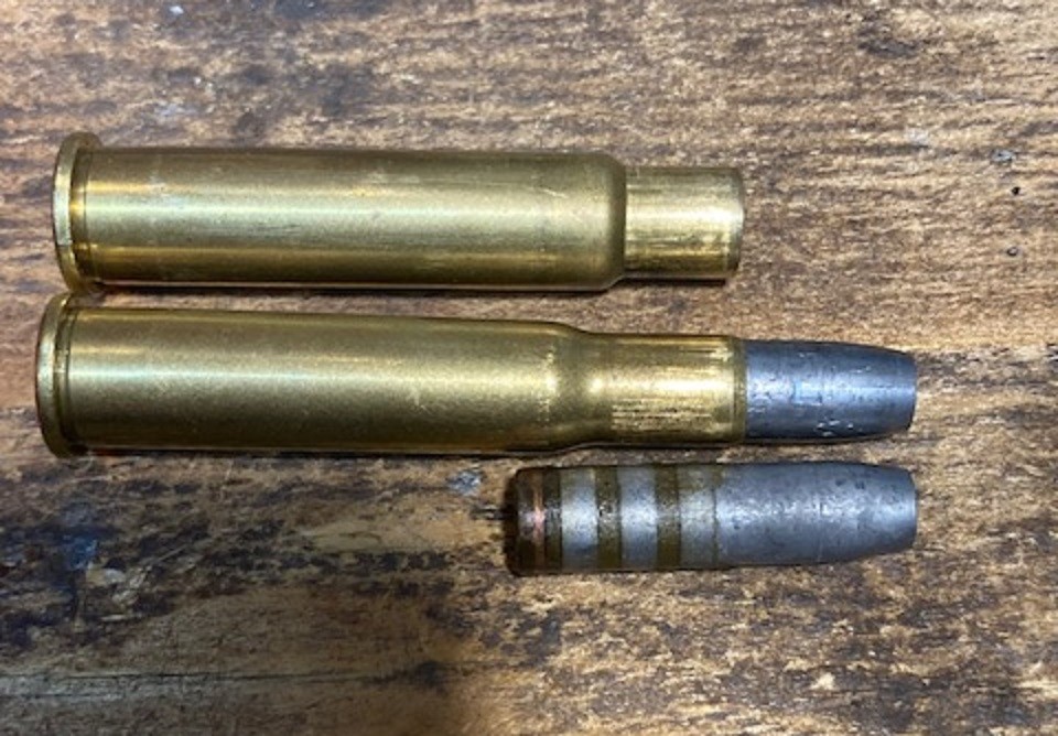

This image (above) shows you the seating depth vs. case neck in the original .30-30 case, and where it would fall in the .30-30 AI case.

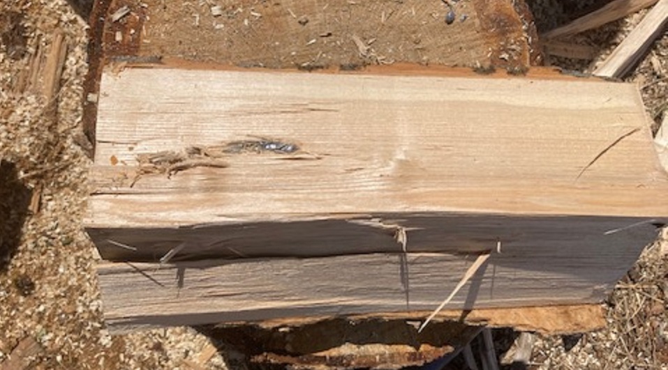

The above image shows how this load penetrated in white ash firewood, penetrating 4.5 inches. I thought this not bad for 220 grains at an estimated 1800 fps... that ash wood is tough.

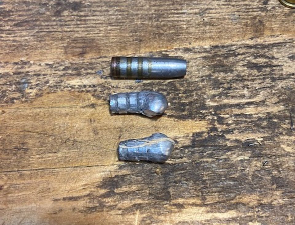

The above image is what two of the recovered bullets look like. Yes, it appears I am now suitably equipped to go hunting trees.
