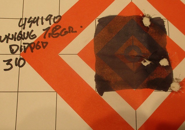

Awhile back I loaded some .45 Colt ammo using Lyman 310 Tool
by JimT, Texas, Wednesday, March 25, 2026, 14:23 (223 days ago)

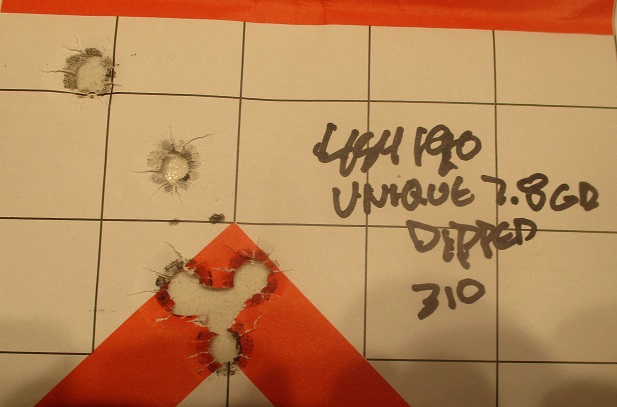

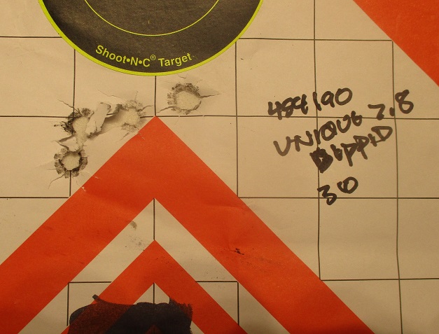

I did not weigh the powder charge .. I used my old Lee Powder Measures (dippers) .. I used the one marked to the throw 7.8 gr. of Unique. The bullet was the old Ideal mold in Lyman 454190 .. the Lyman copy of the original .45 Colt bullet.
I shot some of them today. All were at 20 yards. Some were shot offhand and some using a 2-hand hold and a barrel rest.

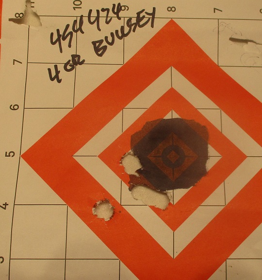

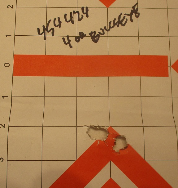

I also tried some loads using 4.0 gr. Bullseye
Next was bullet 454424 over 6.0 gr. Bullseye

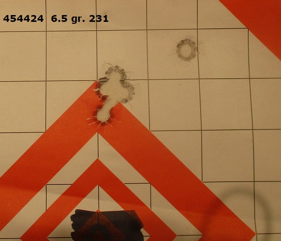

The Bullet 454190 over 6.5 gr. 231
And bullet 45424 over 6.5 gr. 231
The old .45 is still accurate! The shooter ... not so much .. But it was Good Day! The sun was at my back, the target was bright, and best of all .... I COULD SEE THE SIGHTS MOST OF THE TIME!
