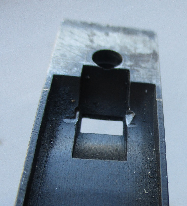

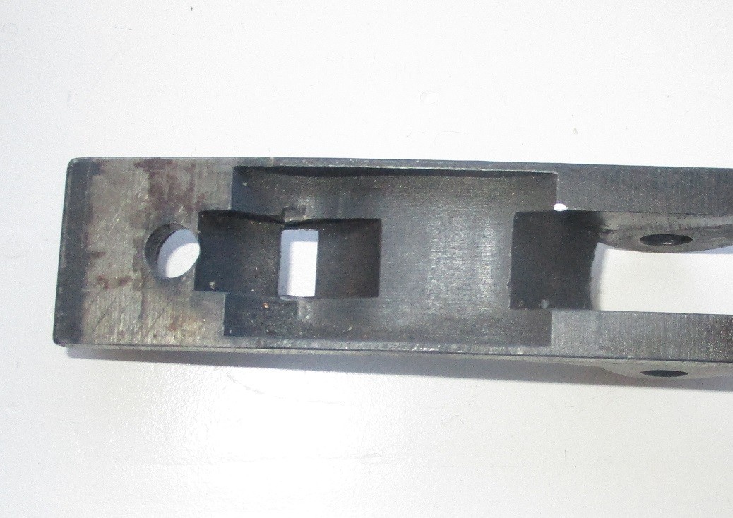

I asked Steve Young about it and he told me to take the lower tang/trigger guard off and look at the inside where the small portion of the carrier sticks through. I pulled the gun apart and discovered this.
You can see where the carrier has pounded divots into the body on each side of the opening.

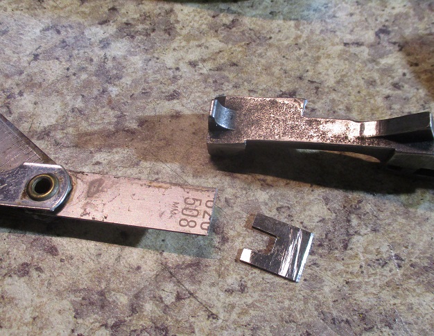

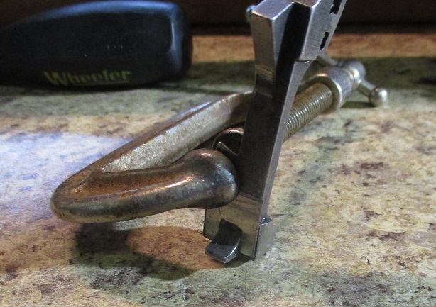

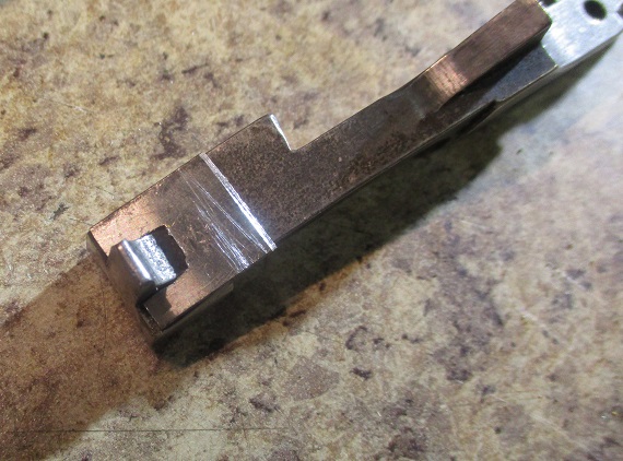

I asked Steve what he did to fix that. He said there are several ways to fix it. What he does is heat the carrier and bend it about .020" or .025". That is beyond my pay grade. Another option is to replace the lower tang/trigger guard. I asked, "Why not shim it?" and he said that would work. So I cut the end off a .020" blade on the feeler gauge and glued it to the carrier.
That did the trick!
Now this was back in August of 2024. A couple days ago I was at the Range, shooting the Carbine and it locked up on me. At home I discovered that the glue on the shim had given out, the shim came loose and was wedged tightly between the carrier and the receiver.
I got it apart and searched the internet and found a used lower tang/trigger guard for a decent price and bought it. When it arrived I cleaned it up and installed it and the Marlin is back in business!
Two things I should have done differently with the shim.
1) - I should have used JB Weld or epoxy
2) - I should have fastened it to the lower tang/trigger guard instead of the carrier
