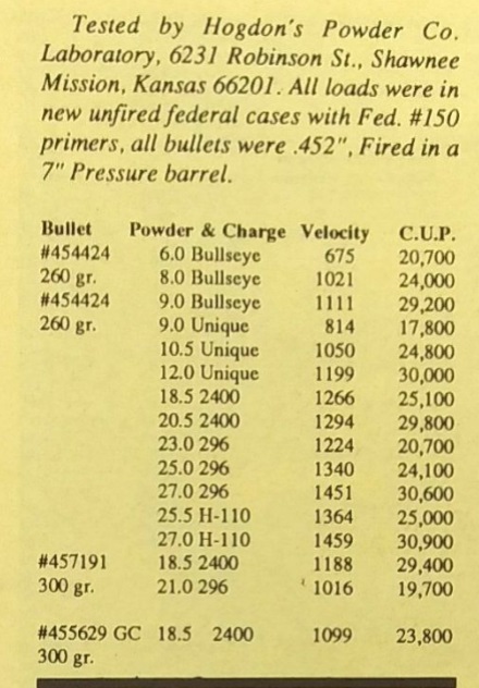

.45 Colt Pressure Data
by JimT, Texas, Tuesday, October 28, 2025, 08:06 (374 days ago)
I am not sure if I posted this before. If I did just ignore this. :-P
Years back John Linebaugh helped me get .45 Colt loads pressure-tested at Hodgdon's in their pressure barrel. John had built the pressure barrel for them and had access to it whenever they weren't running tests.
