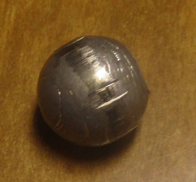

I measured the barrel of the Shootists .45 Colt Marlin
by JimT, Texas, Monday, September 22, 2025, 11:06 (289 days ago)
Using a plastic mallet I started a .457" round ball into the bore at the muzzle. I had placed a rag in the open breech to catch anything that might fall through the bore. I used a 12 ga. cleaning rod to push the ball through the length of the barrel. The barrel was exceptionally slick and smooth all the way through with no tight spots.
It is a 5 groove barrel and near as I can tell, this measures .4518".
