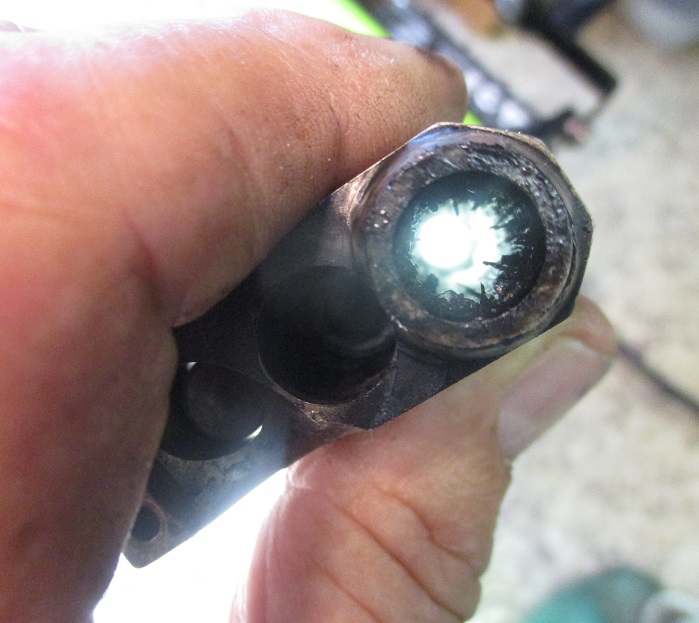

All my years of shooting black powder in percussion revolvers and having to clean up that mess makes me see Unique in a modern revolver as super clean and not sooty at all with no worry about corrosion being another plus.

Here's the barrel of my 1851 Navy after a Shooting Session
by JimT, Texas, Thursday, September 11, 2025, 12:30 (417 days ago) @ JimT
