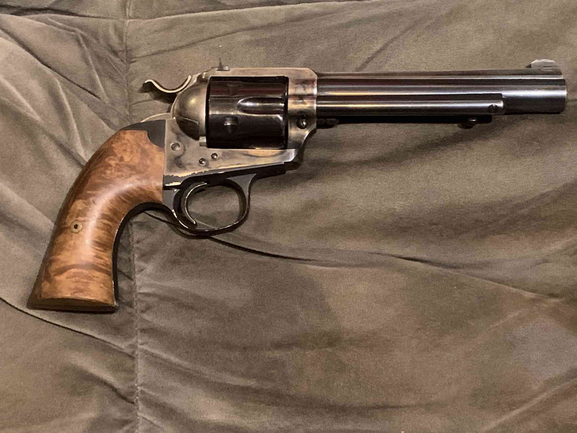

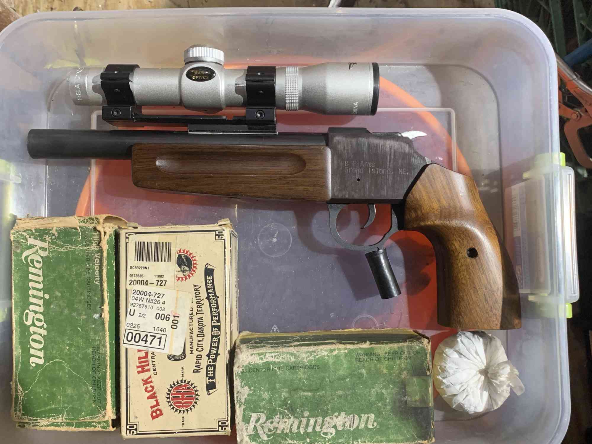

I use Cream'O'Wheat for BP blanks and fire forming. Packs a little tighter than cornmeal. Coincidently I too have been shooting my Uberti 32-20 Bisley SAA and BF single shot lately.[image][image]
Like that Bisley!
by Hoot @, Diversityville, Liberal-sota, Wednesday, July 16, 2025, 08:06 (480 days ago) @ E Sisk
The BFA would be interesting to play with as well. My .32-20's are a Ruger Buckeye, a pre-war K-frame Smith and a Husqvarna single shot bolt rifle.
