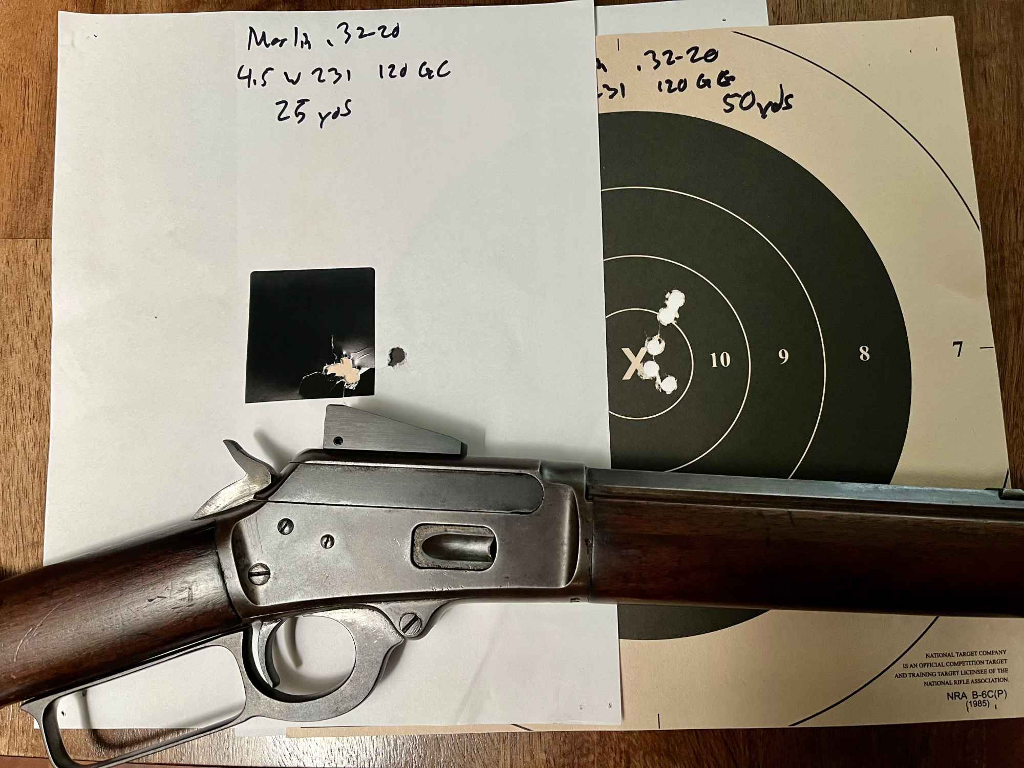

Well, it took a little bit of work but I have my new (old) 1894 Marlin pretty close to sighted in. Still need to head a touch left but I’m happy as of now!

How do you do windage with that sight?

The rear has slots so you loosen the screw(s) and slip it one way or another. Not an exact science but it works.

My old standard load has always been 4.5 of unique. I’ve got a big jug of W231 so I tried it. 4.5 of 231 gives me about 90 fps more and shot nearly identical groups as the Unique, which o have less of. I have some 1680 for .300 blk and have seen it mentioned for .32-20 recently. I might have to give it a try.
Is your arsenal mold plain based or gas checked? This old Marlin has a frosty bore and definitely prefers a gas check. I prefer not to use gas checks but this rifle is so much fun to shoot, I’m willing to get a new mold (rough; I know!) and use the gas checks! This will be my fifth arsenal mold, I think. I really like them!
