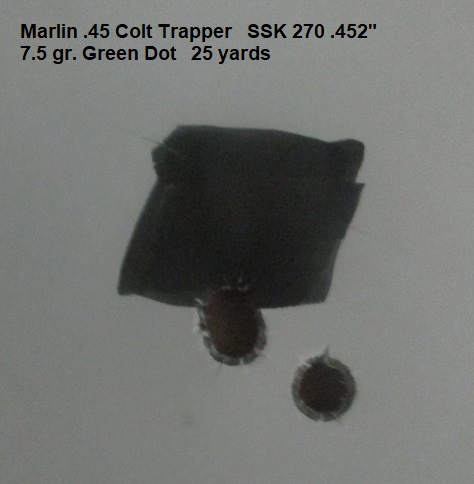

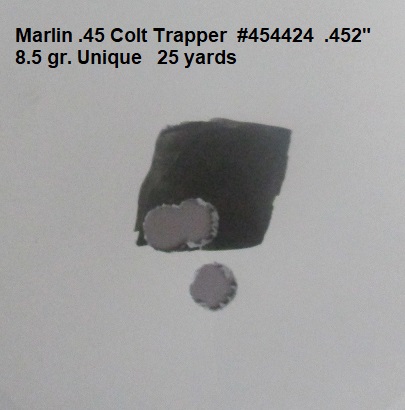

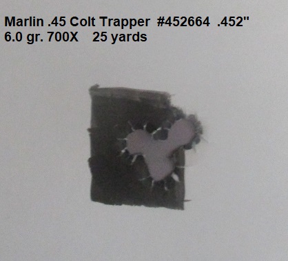

I shot a few of my Heavy .45 Colt loads with the 300 gr. bullet. Recoil is quick and hard .. like the .44 Magnum .. and hurts. I am not interested in getting beat up. I just want to have fun with the rifle and enjoy it. Sticking with the 800 to 900 fps loads.

It definitely seems to be doing well. Have you tried the Lyman 454190 bullet in it yet? I'm trying to remember what I've got in the cache and that's the only mold in there for the 45 Colt that I recall. I've got a decent stash of San Juan Bullet Company (if I recall the name correctly) 300 gr slugs, but we'll just have to wait and see what comes to the top once I get back up there. These definity show a lot of promise!

mostly because I had half a box sitting there. Of course they fed and fired just fine. I used them mostly to acquaint Melodie (I helped!) with the rifle. Not that the 8.5gr. Unique load was all that strenuous.
