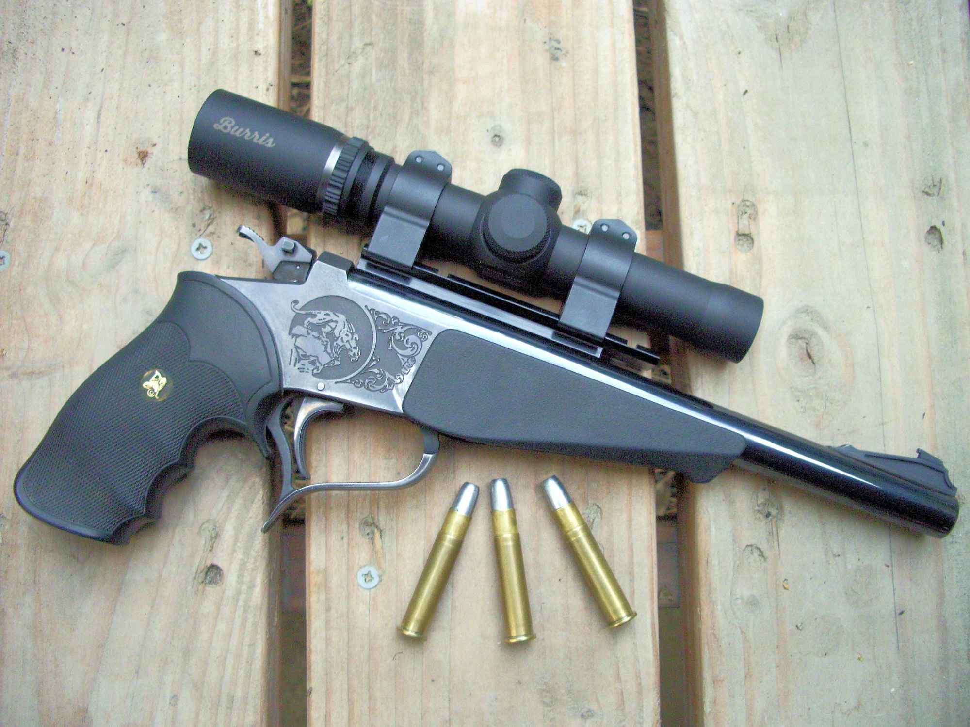

by Glen, Wednesday, May 21, 2025, 15:43 (536 days ago) @ AaronB
...and it works nicely in a Contender too.
A pretty setup
by AaronB, Wednesday, May 28, 2025, 14:47 (529 days ago) @ Glen
I like that rig. Looks entirely capable for shooting silhouettes, or for hunting.
