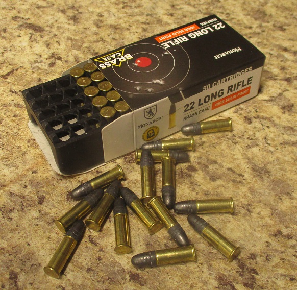

I was in Academy Sports today and found .22 Long Rifle ammo for 6 1/2 cents a round ... so you know I had to buy some. They are "Monarch" brand ... a name for Brazilian-made ammo for distribution by Academy. The ammunition is produced by Companhia Brasileira de Cartuchos (Brazilian Cartridge Company), Avenida Industrial No 3330, Santo Andre, Estado de Sâo Paulo, Brazil and carries the CBC headstamp. I have seen that headstamp on 9mm ammo but never on .22 rimfire, not that I have been looking for it.
The cartridges have a 40 grain lead bullet and are typical of the cheaper American-made ammo that is put out by Federal, CCI etc. Buying it reminded me of when I was a teenager and Dad was always buying the cheapest .22's he could find. It was the best way he could keep me shooting and not break his wallet.

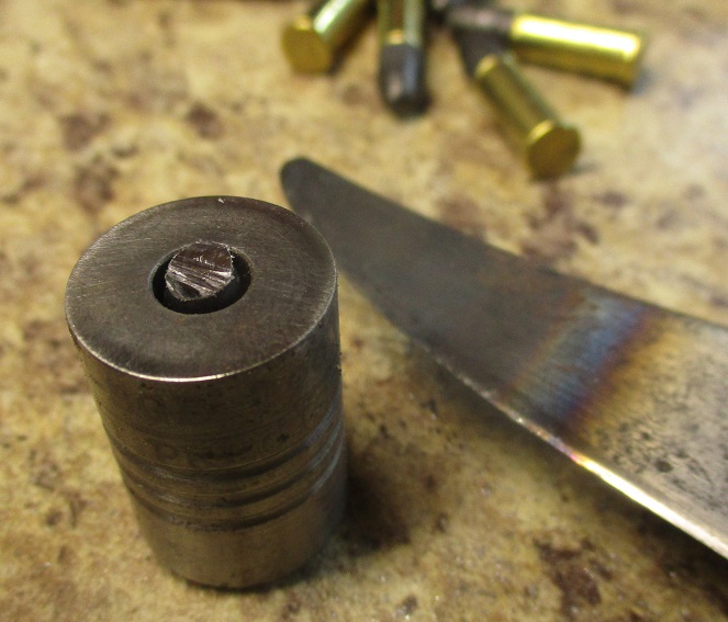

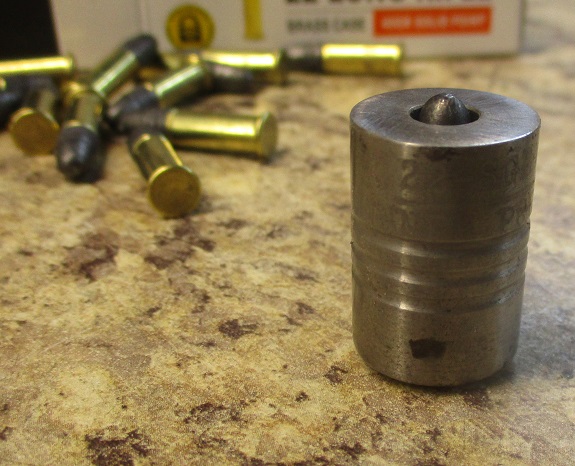

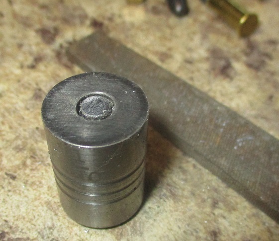

I still have one of the original SGB Tools. The Second Variation is larger around and easier to hold, the sides being knurled. But I dug the old one out this afternoon and modified a box of the Brazilian .22's.

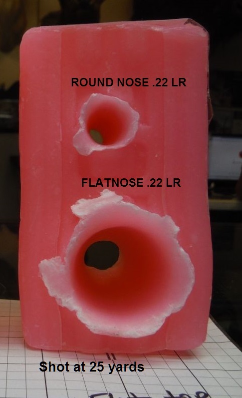

This photo is from his website showing what the flat nose can do.

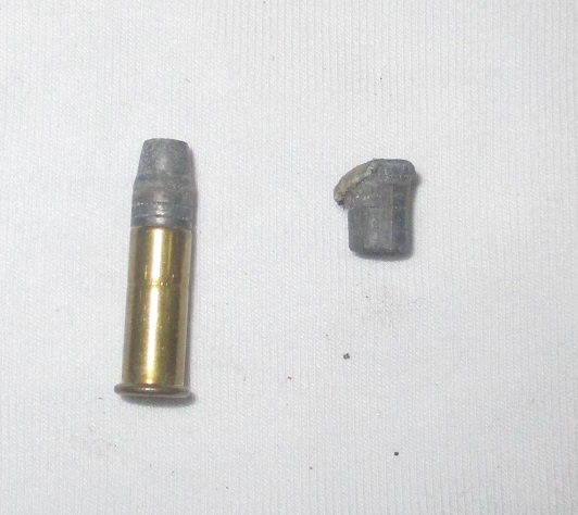

I shot a lot of game years ago with the SGB bullet. The largest critters I shot with it were Javelina. They would come in our yard at night and fight with the dog and root up the wife's flowers and fight among themselves over the peaches that fell from our trees. About 2AM one morning I grabbed my .22 rifle and ran out the door and fired amongst them. One fell over. The next day I cleaned it and found the bullet under the hide on the off side. The load was a Standard Velocity Remington .22 Long Rifle. This is the ammo and the actual bullet.
I shot other Javelina at distance to 25 yards with the SGB bullet and never had to shoot one twice.

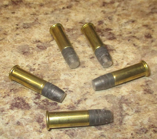

Now I have 50 rounds finished and one of these days I will shoot them for accuracy and them maybe do a test where I shoot them against commercial hollowpoints and recover the bullets for comparison. That might be fun.
