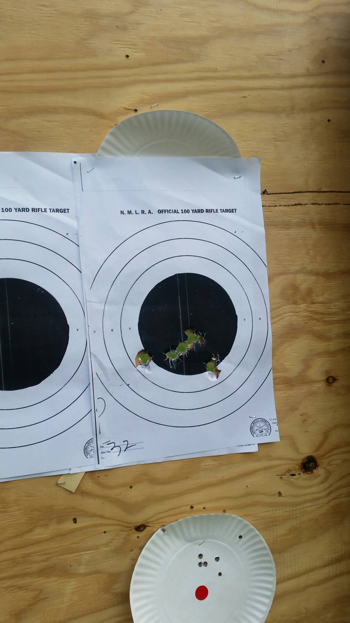

Shot a Pedersoli for several years. The first picture of the target was shot at 50 yards from a rest. The Bess is a 50-yard deer gun in my opinion. The deer above was shot with 80 grains of 2g Goex and a patched .715 ball at 60 yards. The ball entered the lungs and exited breaking the offside leg. The deer bled out with 30 yards. Wish I had never sold it. They have a lot of fiddle factor.
Bob
