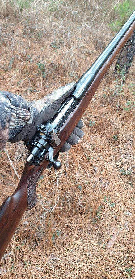

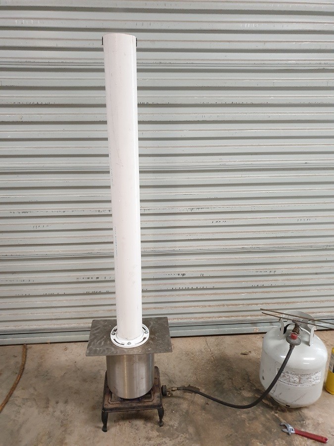

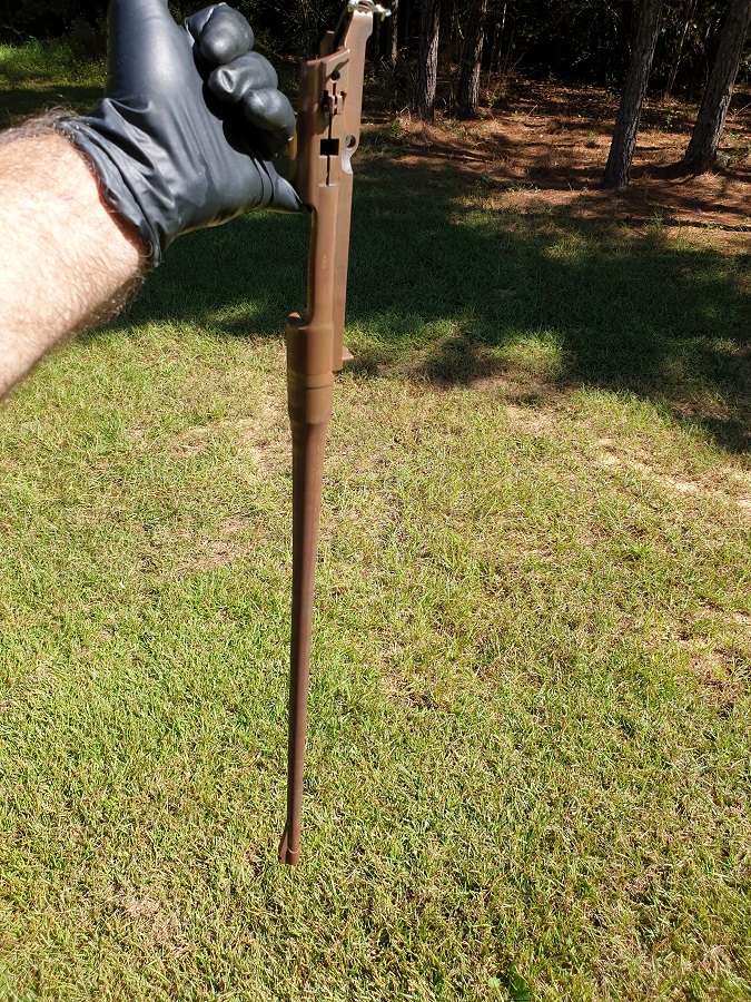

by JohnKDM, Monday, January 20, 2025, 15:43 (669 days ago) @ Hoot
Rust & card for browning. Repeat until satisfied.
Rust, boil (or steam) and card for bluing. Repeat until satisfied.
I started with Pilkintons and tried others like American Rust Blue (rustblue.com), then Laurel Mountain Forge. The last seems more forgiving of not-perfect cleanliness.
In the winter during periods of low humidity I hang my parts in my shop bathroom at the end of the day, take a shower and leave them overnight. You can make a rusting box from a cardboard box and a light for a bit of heat.
The soft carding wheels and brushes are available from Brownells.
That there...
by Paul ⌂, Tuesday, January 21, 2025, 08:36 (668 days ago) @ JohnKDM
P17 always makes my heart go pittypat...
