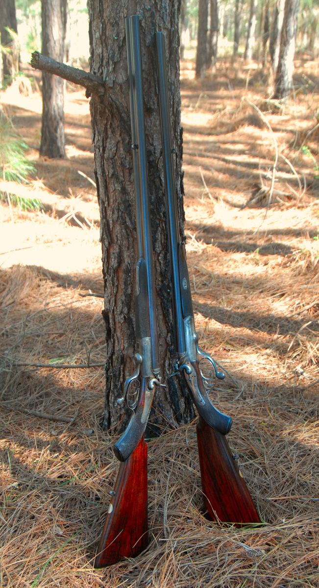

This 1870s one belonged to a customer and had some issues, particularly in the locks. I like to think it was dropped out of a howdah in India when a tiger attacked, but I am weird.
You guys and your strange rifles...
by JohnKDM, Friday, December 13, 2024, 09:33 (667 days ago) @ JohnKDM
The 1870s Rodda 450bpe is on the right, my 1880s Braddell 500bpe on the left.

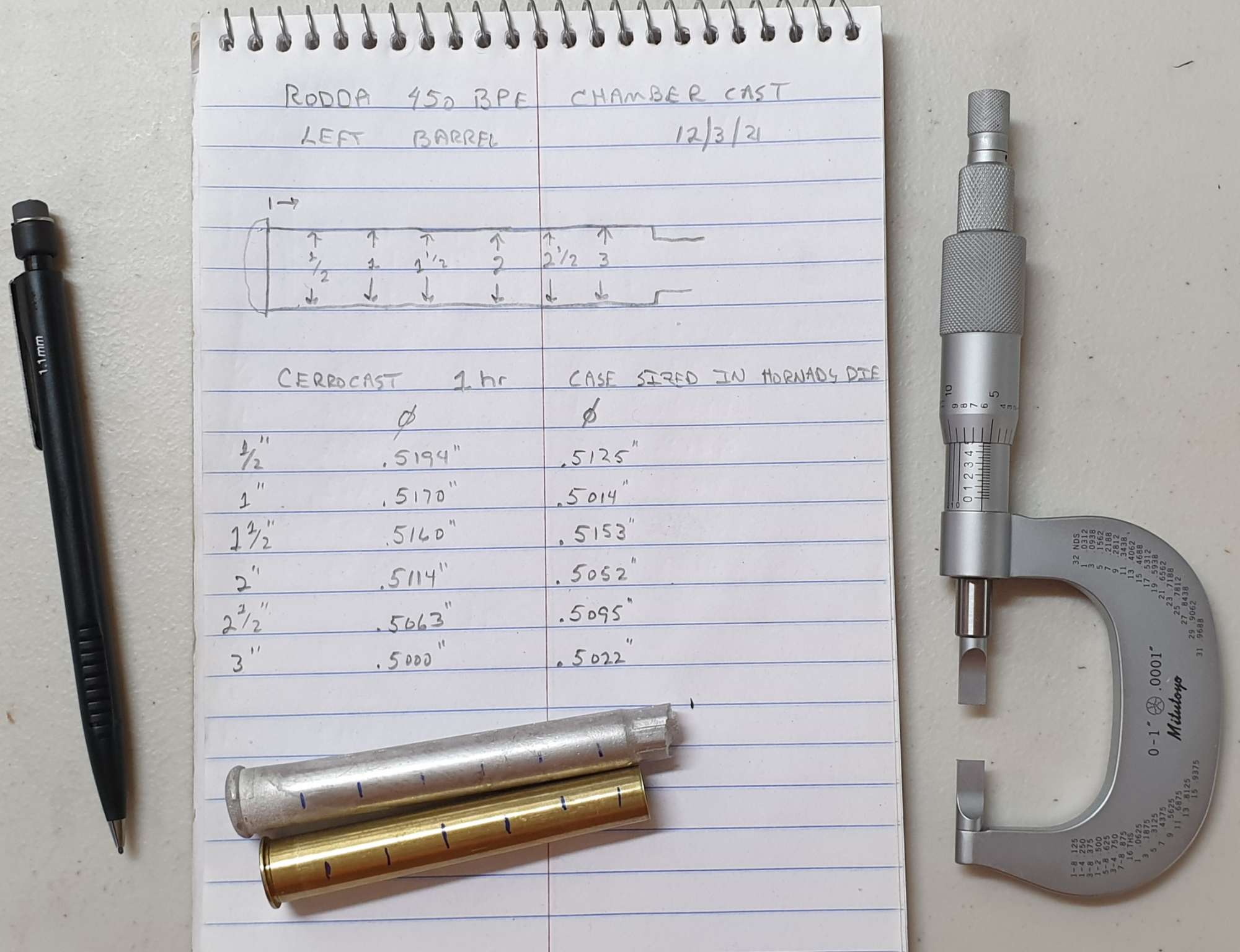

I have discovered that of course one may rent a .450 Nitro Express reamer. I'm thinking that running into the older rifle's chamber would be a fairly simple hand operation. Reaming the Handi-Rifle might be more than I wanted to take on at my skill level; getting the extractor right would be the trick.
.450 NE Reamer
by JohnKDM, Friday, December 13, 2024, 12:48 (667 days ago) @ AaronB
Easily done on the coiled case chamber and works well.
Haven't recut a Handi, so unsure of any gotchas.

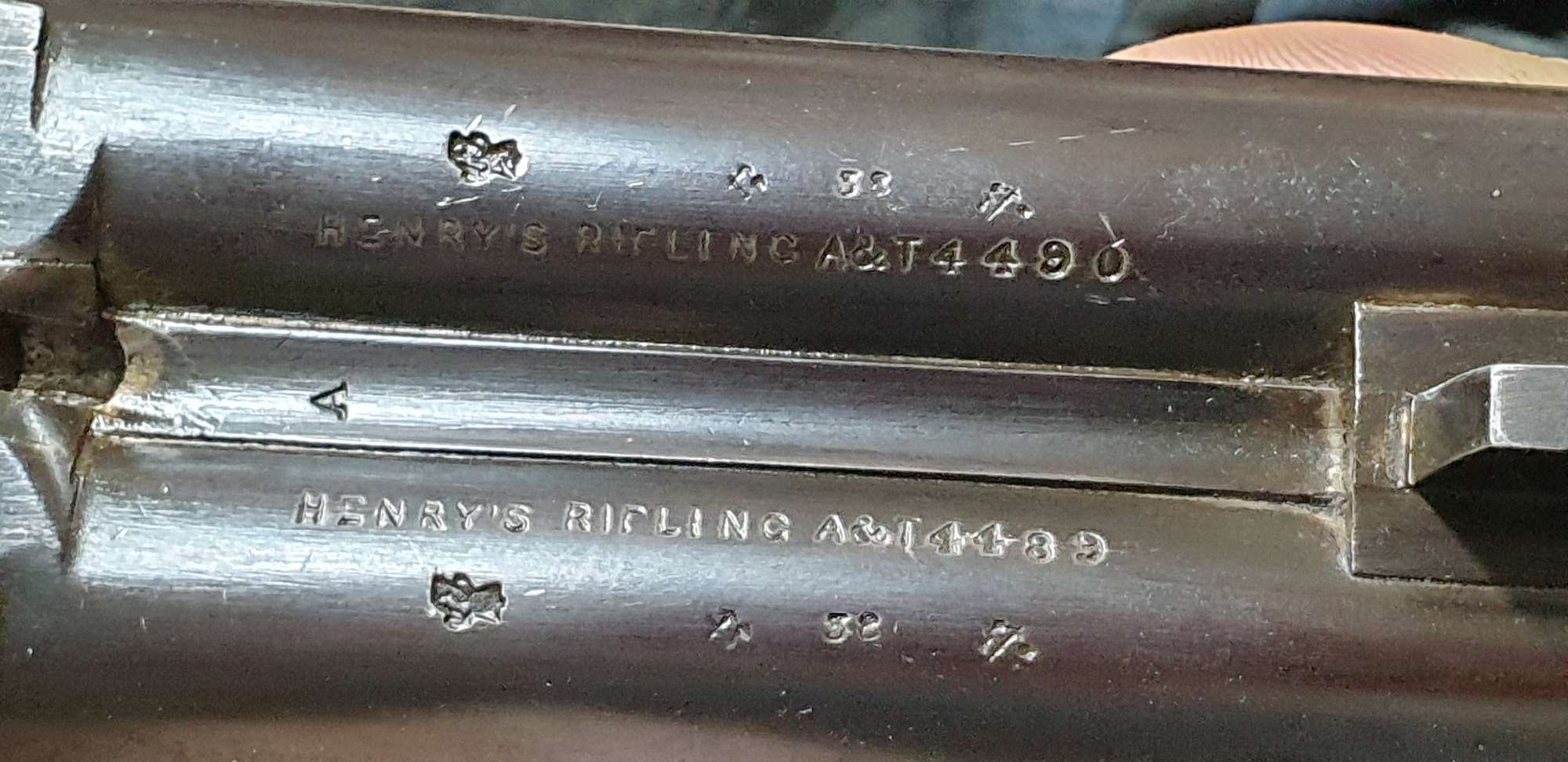

Not a lot of standards back in the BPE days, and yet the Adams & Tait (sometimes spelled Tate) barrel makers could probably be considered to be making a 'standard' twist since a lot of firearms makers used their rifled tubes. My Braddell used them, and you can see their "A & T" stamp and their barrel serial numbers which were also likely used to keep track of money owed Henry for use of his rifling. Now wish I had measured the 450bpe twist while it was here.
