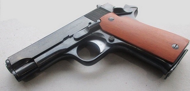

Back in 2020 I was looking for something to mess with and found on J&G SALES website a sale on Star BM 9mm autoshuckers. They were selling them for $299.00 and since I had not owned a 9mm since the turn of the century I decided to order one, which I did. They are a decent all-metal pistol which appeals to me, though I am not a big fan of the caliber. But I figure it's a good caliber to own since ammo is everywhere and in troubled times that may be important.

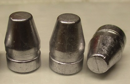

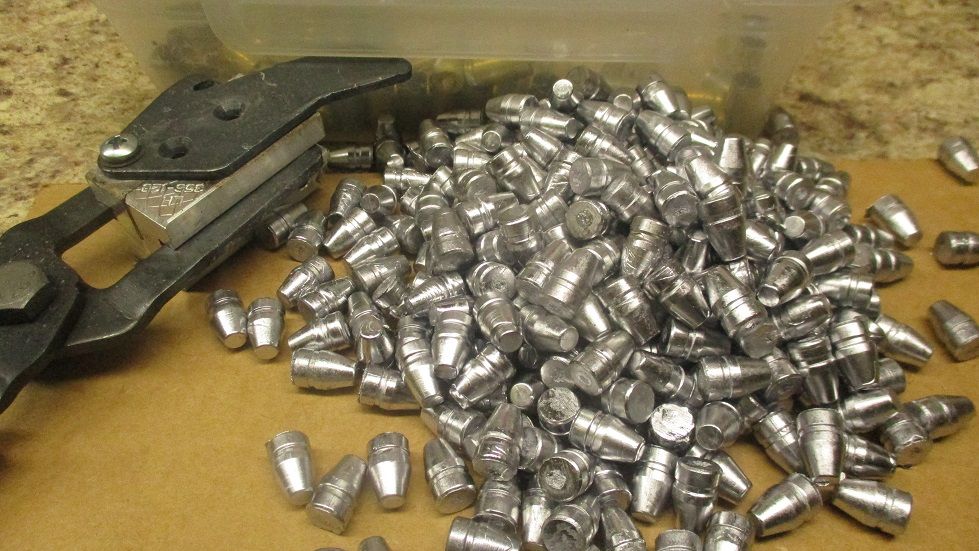

I had been buying excellent bullets from Bear Creek Supply. Their 125 gr. round nose is an accurate bullet and really is clean barrel-wise. But I would much rather make my own so I ended up purchasing a Lee double cavity mold for their 120 gr. truncated cone bullet – the Lee 356-120. With my alloy of 10/11 BHN the mold throws them at 124 – 125 grains.

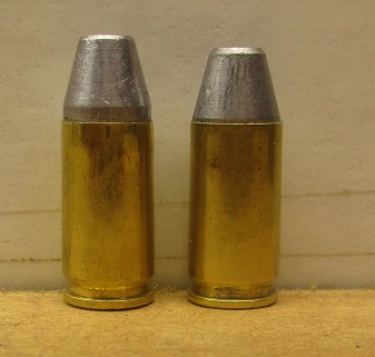

I cast about 400 or so and started loading some to see how they shot. The first loads I assembled I seated the bullet as deep as possible and used a 3 grain charge of Bullseye under them. They fed well and functioned fine but shot patterns instead of groups. They also hit about 7 inches high and 3 inches to the right.
Factory loads and my handloads with the Bear Creek bullet hit a little high but fairly centered so I seated the next batch further out and increased the powder charge to 3.4 gr. of Bullseye. These grouped well and hit closer to where the factory loads hit. So I upped the powder charge of the next loads to 5.0 gr. of Power Pistol in one bunch and 4.5 gr. Unique in the other. We shall see how they do.
The cartridge on the right is the first that I tried. The left side one is what I ended up doing.

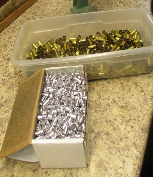

10.5 pounds of bullets -I have 800 or so cases sized, neck expanded and primed ... ready to load.
