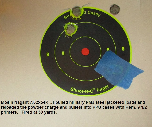

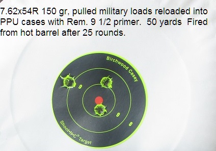

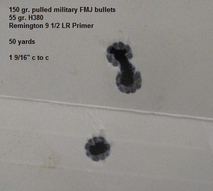

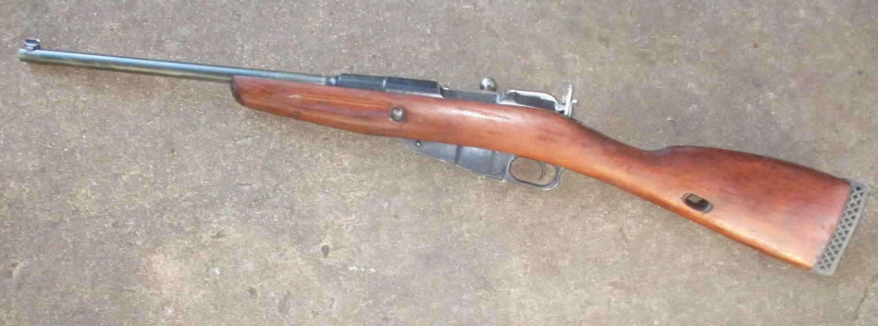

like the Russian 7.62x54R .. I spent a lot of time playing around with it and figuring out how to get a worn barrel to shoot minute of Whitetail. :-)
It had a bayonet fixed on the barrel. The barrel was worn .. the muzzle area worst of all but overall it was not real good. I cut it down, floated the barrel, made a peep sight for it and experimented with different loads. Got it to where it will work for deer.
It ain't nothing to write home about but I had fun doing it.
That striker mounted peep...
by Paul ⌂, Monday, December 02, 2024, 19:50 (707 days ago) @ JimT
is one cool piece o' kit!
It was the perfect place to mount a peep on this gun ....
by JimT, Texas, Monday, December 02, 2024, 19:57 (707 days ago) @ Paul
but it wasn't my idea. It was the answer to the question I asked.

Your Mosin appears to me to be just about the perfect behind-the-truck-seat rifle for knocking around. Throw a cuff on it with some ammo and it's a great grab-and-go utility carbine. I can appreciate the butt pad. :-)

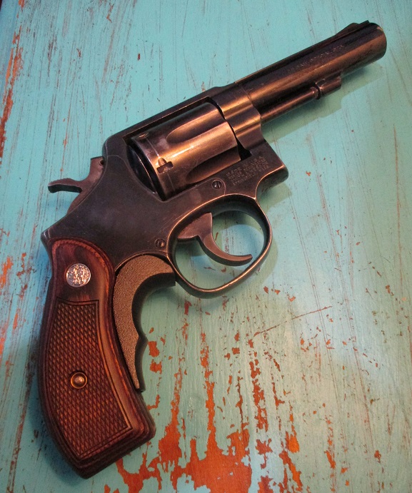

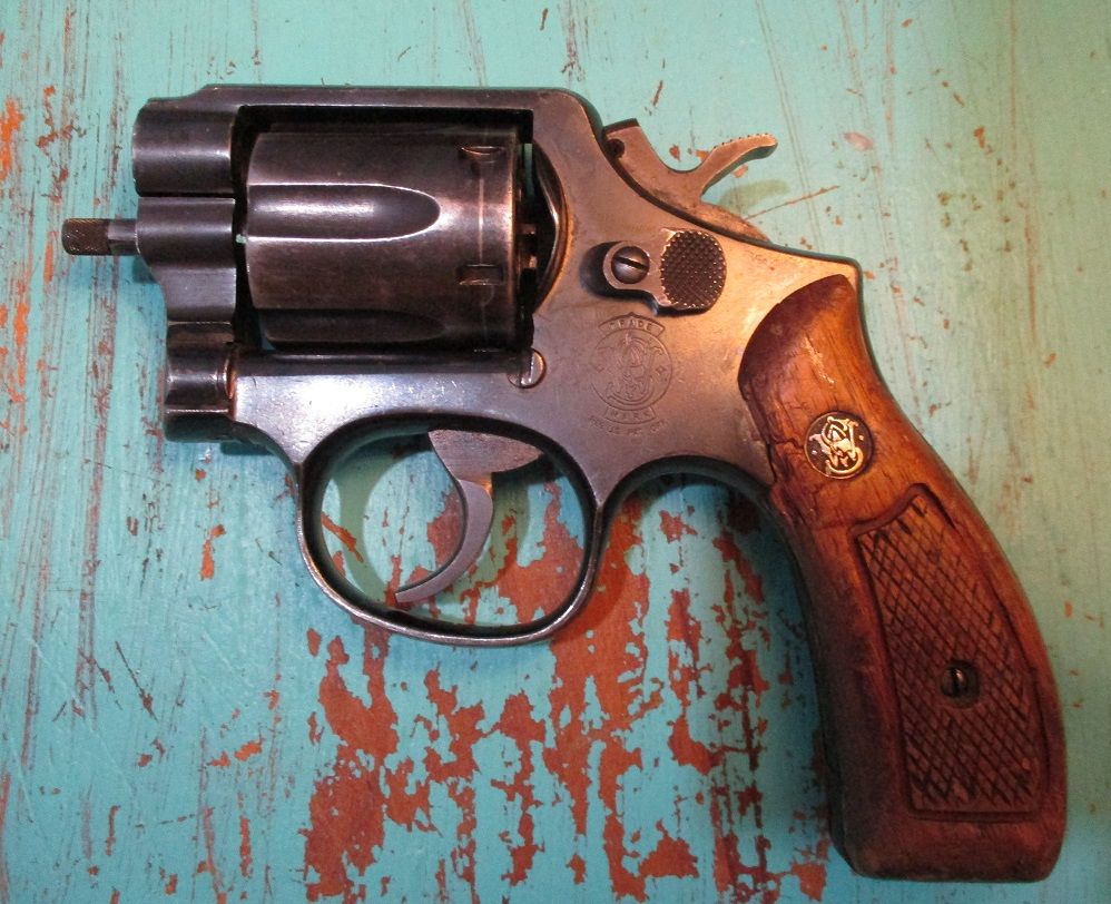

I bought a S&W Model 10 that did not have a barrel or any of the "front parts."
Bought the parts I needed and got it together.
It is surprisingly accurate.
But it is dingy and the finish is gone in places and I keep getting tempted to have it all reblued. So far I have resisted. :-)

That is purty! But ...
by JimT, Texas, Tuesday, December 03, 2024, 12:13 (706 days ago) @ AaronB
if my old beater looked that good I'd be hesitant to shoot it, much less stick it in my pocket and walk around town. :-P
