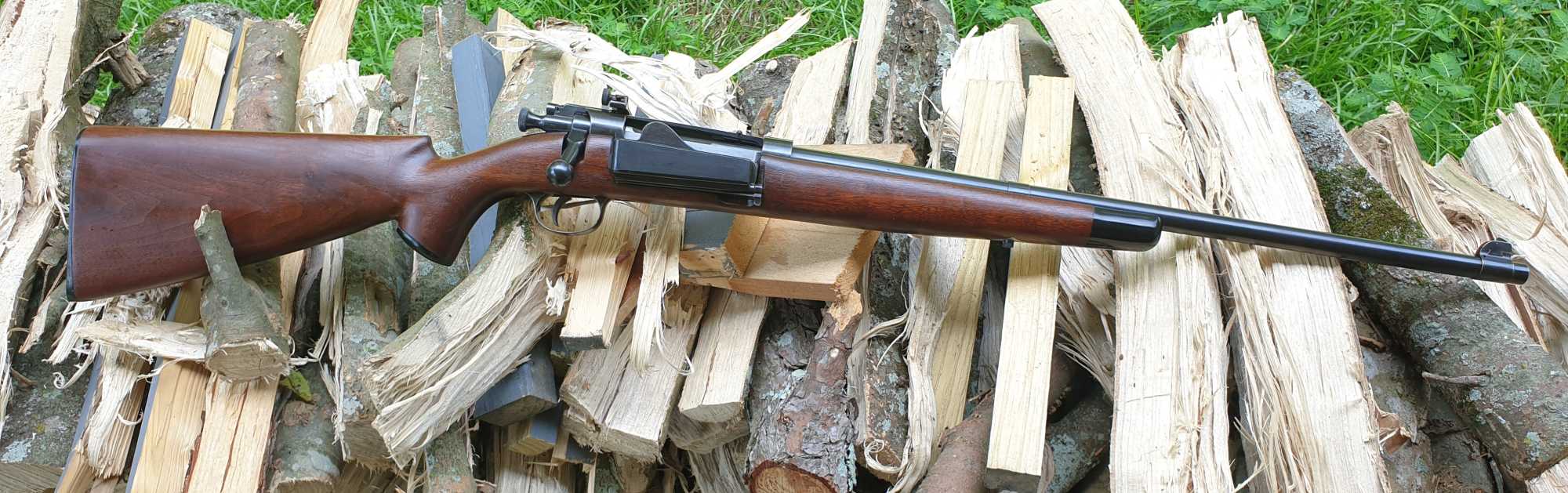

This 30-40 sporter Krag belonged to Terry M. Obtained it after his passing. I already had a nice 30-40 sporter, but this one was Terry's - he always wanted to shoot my Krag at the Holiday, so I could not resist.
Unfortunately, the bore was too far gone on his. I could've rebarreled, but wanting to keep it as Terry owned it, I turned to JES to rebore it to 35 Krag, which had always held my interest.
It is quite nice. After the barrel came back, everything was rust blued and the stock refinished. Dialed in a Lee 30-40 size die in the lathe and opened the neck to to suit. Works fine.
Still working on loads, but it shoots a 280gr PP pretty well and gives just under 2000fps. Also likes the 200gr Remington PSP Corelokt. Killed one deer with it, using a 310gr lead slug that Jared sent me to try. I think he intended that bullet for a 35 Whelan.

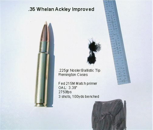

I tend to believe a 12 or 14 twist is fine for 35cal rifles. The 16t that Remington used is a bit slow for the bullet weights (length) we like. So far, I have no issue stabilizing 280s @ 1900fps with a 14t, though I could see a 10t if 300+gr subsonics were planned.
Most of my experience over the last 35yrs has been with 225/250gr bullets in the 35WAI and they shoot quite well, even the old discontinued 250gr XBT. The also discontinued 225gr Nosler BT shoots well and is excellent deer medicine. Notice a trend? The 35cal bullets just don't sell as well as 30 and 338cals and the manufacturers drop them for the latest internet hotness. As usual, my ubiquitous statement of "if you find something that works, stock up" applies.

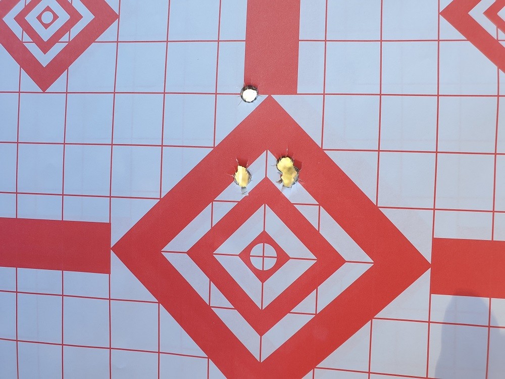

Here is a target from the 35 Krag
by JohnKDM, Wednesday, November 27, 2024, 11:28 (713 days ago) @ JohnKDM
100yds, Redfield receiver sight, five shots.
The load was a 280gr paper patch bullet, 16bhn, over 40grs of IMR4895, 1930fps average MV. As usual, there was one anti-social so-n-so that landed up north away from its friends.

by AaronB, Sunday, December 01, 2024, 18:38 (709 days ago) @ JohnKDM
That's a pretty group for irons at 100.
It speaks well for the cartridge (not to mention the rifle and the shooter).
