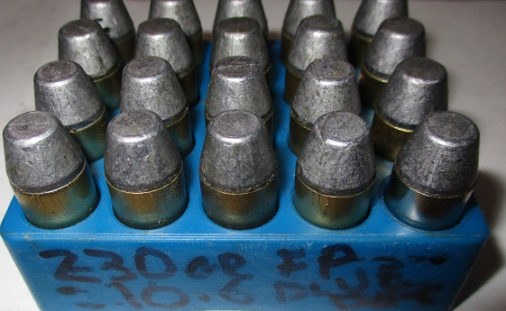

Playing with the .45 ACP, some time back a friend who I will not embarrass but whose initials are John Killebrew sent me some 230 gr. flat-nose bullets. These are just the right shape for really efficient bullets in the .45 ACP.
I tried some with 10.6 gr. of Blue Dot and found them to be accurate and pretty stout! Over the chronograph they averaged 1034 fps. I figure plinking with them would hammer the auto after awhile but as a carry load they have enough power to punch through a car door or several inches of wool clothing and fat.
They do recoil enough that fast follow-up shots would be a little slower.
I put some more together this past week and am looking forward to trying them out. I cut the Blue Dot load to 10.5 gr. and loaded some with 6.5 gr. Unique and some with 6.0 gr. 231. I plan on shooting them and seeing which are them most accurate and consistent.

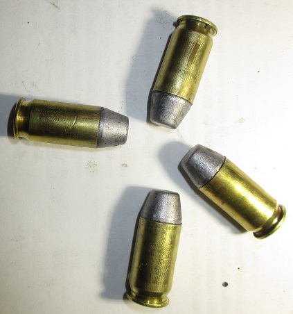

Jim:
I've been using that bullet for years and it's a dandy in the .45. I don't run it nearly as hot as your loads - about 750-800 fps depending on barrel length. Got a Combat Commander that really likes that load and it don't beat up my creaky old hands like hardball.
I like the 800 to 850 fps loads ...

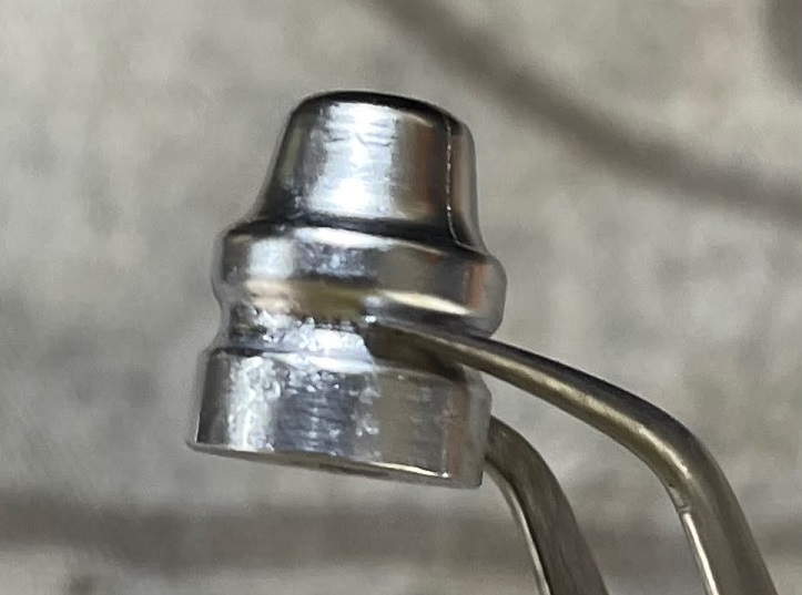

I have been loading a slew of Lyman 452488's... 200-grain SWCs... over 9.0 grains of Blue Dot for use in my M25-5 resolver. Now that I see you're shooting 230s over 10.5 grains in your semi-auto, I'm reassured that I'm not likely to blow myself up with those loads any time soon.
BTW, the 452488 seems to work quite nicely in the Smith 25-5, with the caveat that they don't want to chamber cleanly unless I've run them through my .45 Auto Rim roll crimp die. Of course, that seems to be a requirement for all my cast .45 loads.
