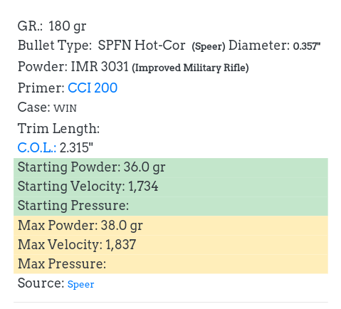

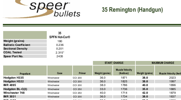

by RayLee, Wednesday, August 28, 2024, 07:22 (803 days ago) @ AaronB
And that velocity......
by RayLee, Wednesday, August 28, 2024, 07:32 (803 days ago) @ RayLee
is apparently from a 14" barrel.
And the reminder to always.....
by RayLee, Wednesday, August 28, 2024, 07:57 (803 days ago) @ RayLee
cross-reference vintage data with later bullet manufacturers manuals & powder companies pamphlets further confuses when the maximum load from one is below the starting load from another.

by AaronB, Wednesday, August 28, 2024, 15:02 (803 days ago) @ RayLee
I'm reloading the cases with 37.0 grains.
