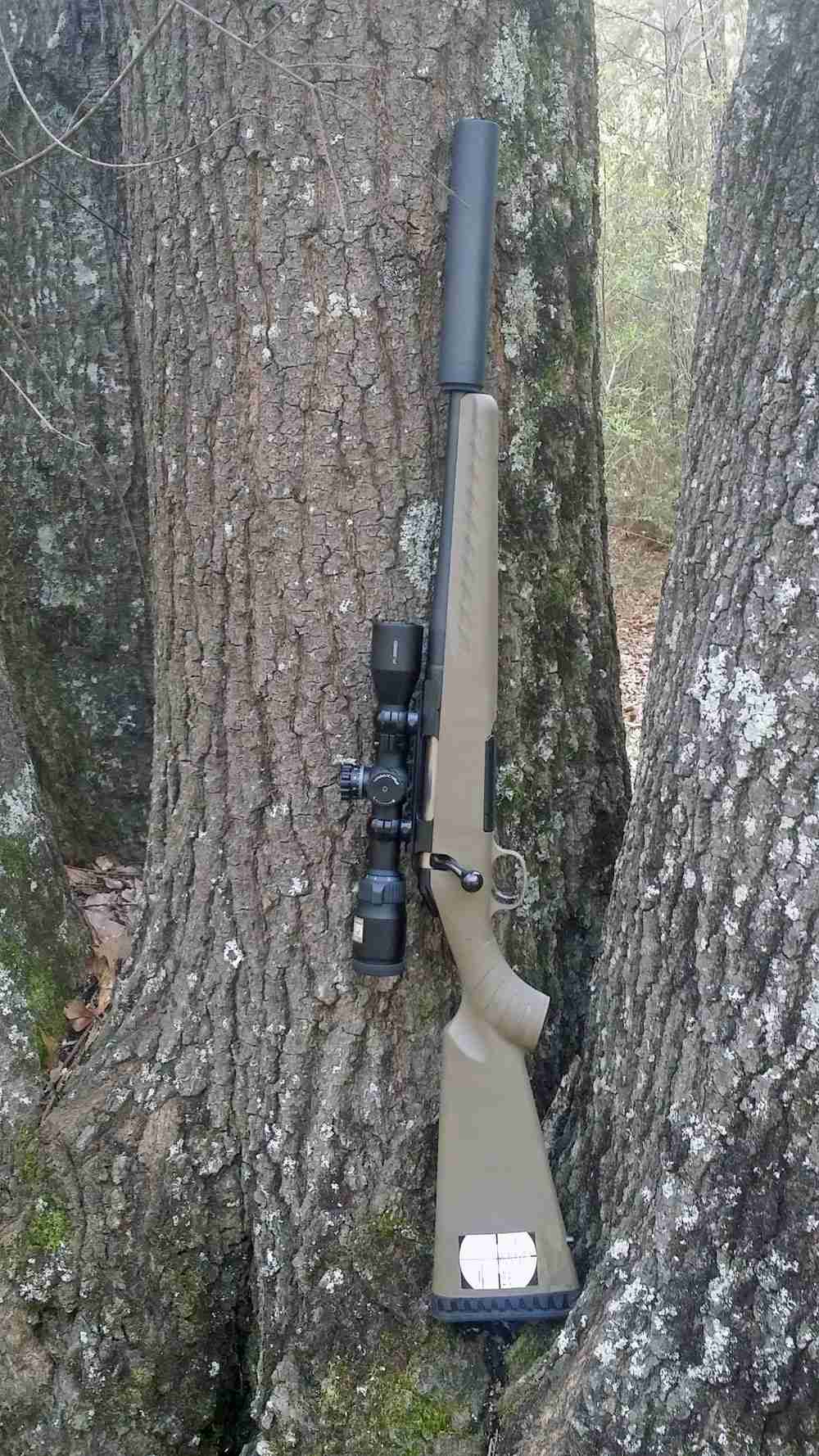

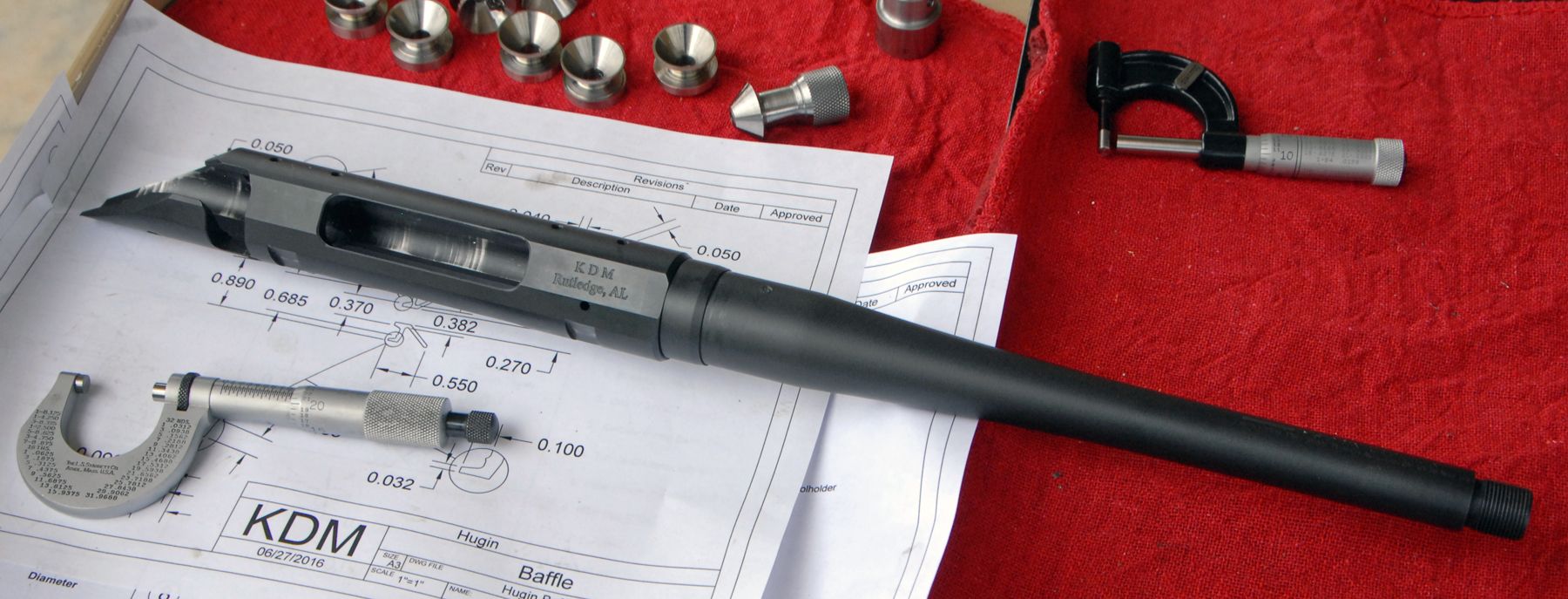

by JohnKDM, Thursday, August 08, 2024, 20:05 (823 days ago) @ A K Church
![[image]](images/uploaded/2024080900532866b568889d224.jpg)
![[image]](images/uploaded/2024080900551366b568f193b24.jpg)

by A K Church, Thursday, August 08, 2024, 20:14 (823 days ago) @ JohnKDM
AHHHHHHHHHHHHHHHH!
OOOOOOOOOOOOOO
by A K Church, Friday, August 09, 2024, 03:32 (822 days ago) @ A K Church
So Suppressor John, tell us more, PLEASE.
