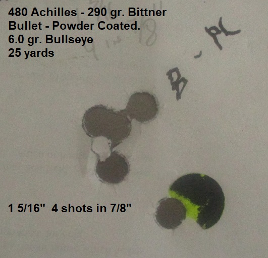

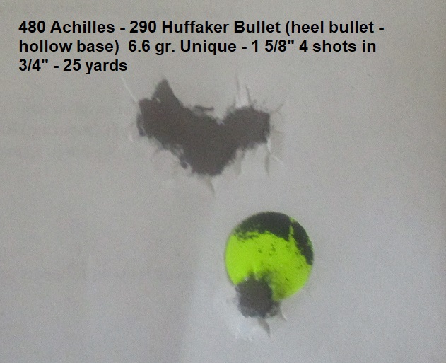

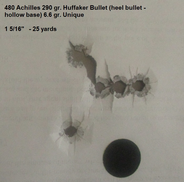

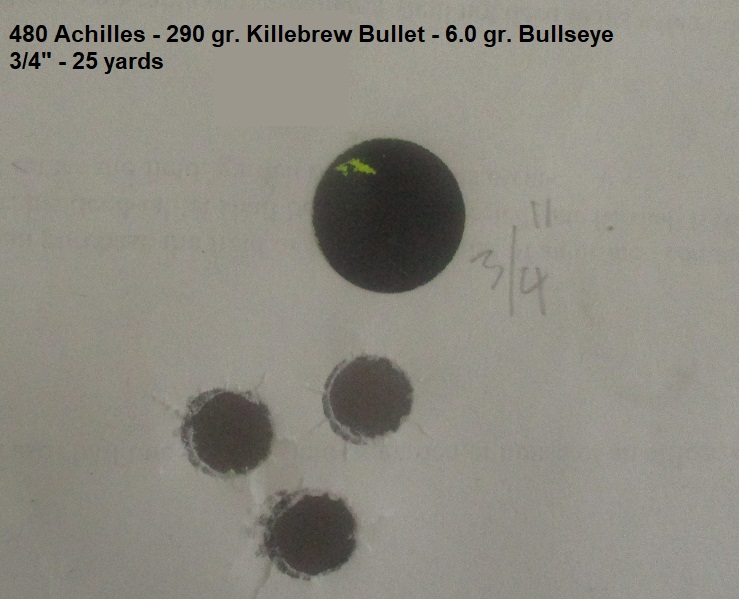

I had a box of loaded ammo with mixed bullets ... some the original Bittner Bullet ... some the Huffaker Bullet and 3 with the Killebrew Bullet. All were loaded with 6.0 gr. Bullseye and I wanted to shoot them up so I could reload the brass. I also took a box loaded with the Huffaker Bullet over 6.6 gr. of Unique.

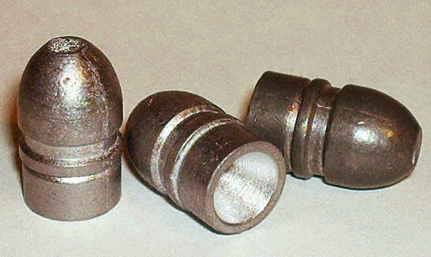

Huffaker Bullet .. heel .. hollow base with crimp groove

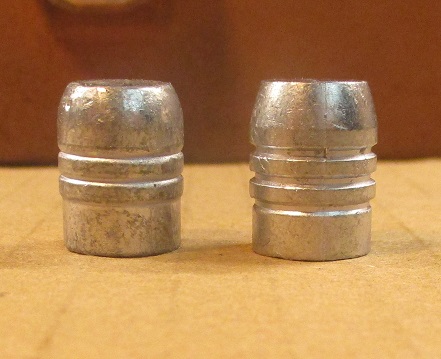

Bittner Bullet -left ..... Killebrew Bullet - Right

I only had 3 rounds with the Killebrew Bullet with me. They are an accurate bullet as I found in previous shooting.

Yes. I try to get a good crimp always. And it is easier
by JimT, Texas, Tuesday, July 16, 2024, 17:34 (794 days ago) @ JohnKDM
with your bullet and the Huffaker bullet as they have a crimp groove. That helps a lot.

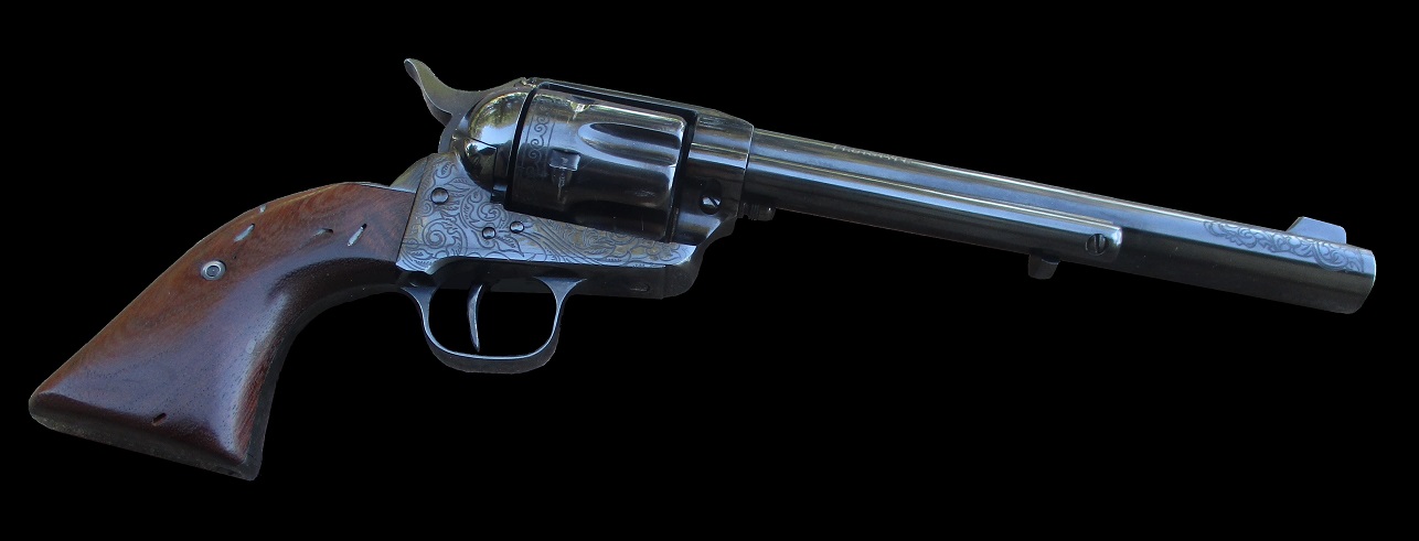

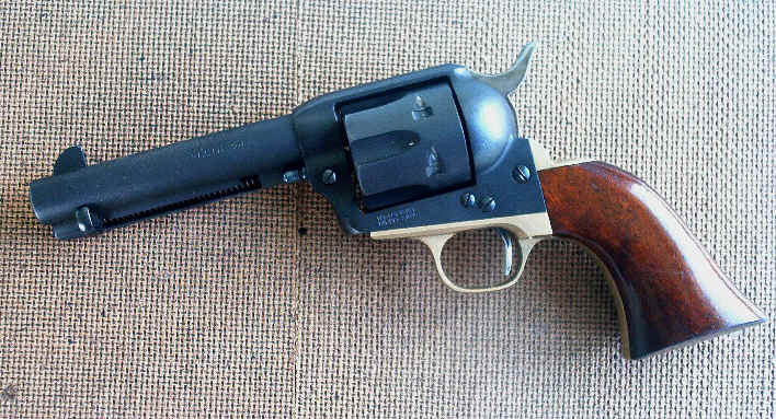

I saw the revolver before the work was done on it. It had brass backstrap and trigger guard before it was converted, didn't it? And a very low, sorta crude polish?
Yes ... it was a cheap Uberti ..
by JimT, Texas, Wednesday, July 17, 2024, 19:04 (793 days ago) @ A K Church
called ""Cabela's Millennium" ... put out by Uberti for Cabela's. This is the "before" photo.
![[image]](images/uploaded/2024071800032566985bcd60170.jpg)
When I sent it to Gary Reeder I included a Colt SAA backstrap and triggerguard that I got from John Taffin to replace the brass furniture.

Huffaker hollow-base
by AaronB, Tuesday, August 20, 2024, 09:46 (760 days ago) @ JimT
I see that the Huffaker is a hollow-base design, which makes sense since we want that skirt to engage the rifling.
In practice, though, these targets don't seem to indicate that it's a significant improvement over the soft solid heel and a middlin' load of fast powder.
That's counter-intuitive to me... not that the hollow-base design did poorly, but that the solid-base designs did equally well.
