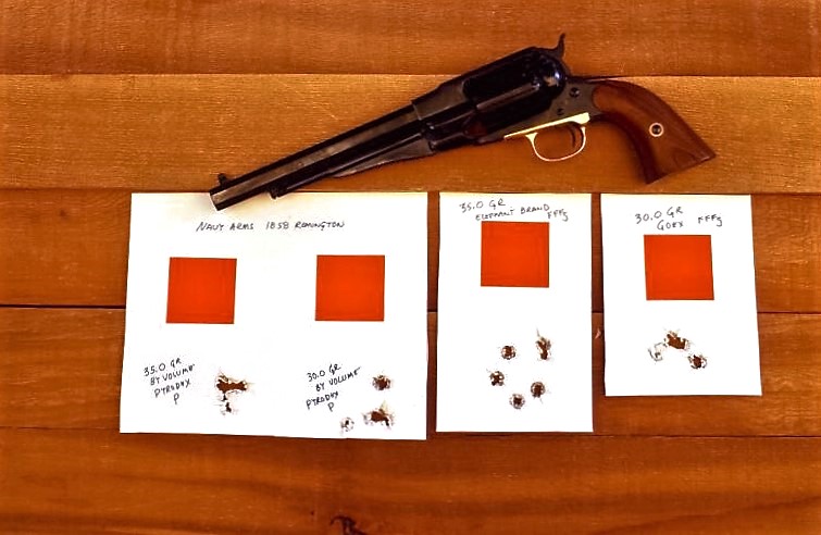

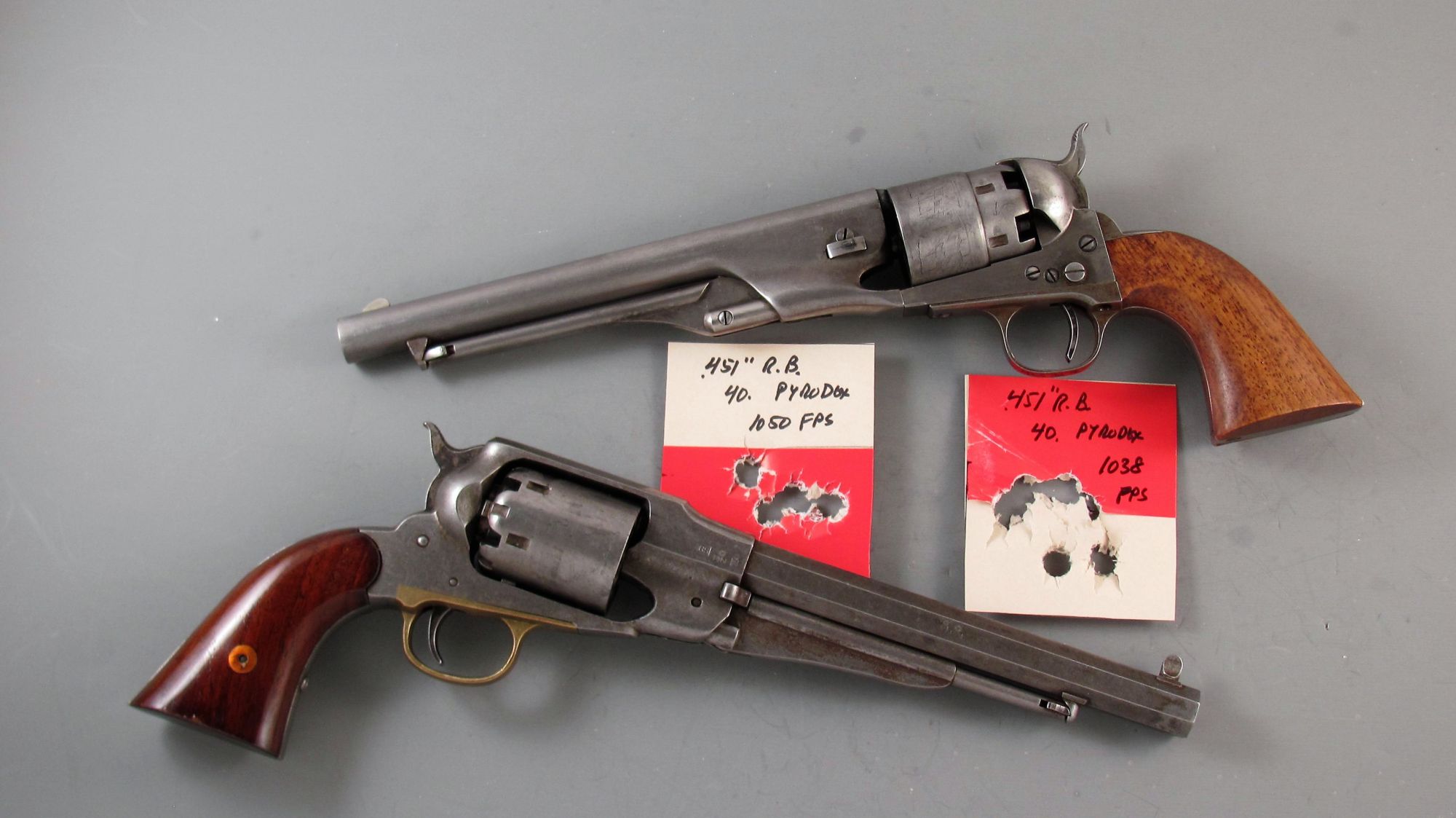

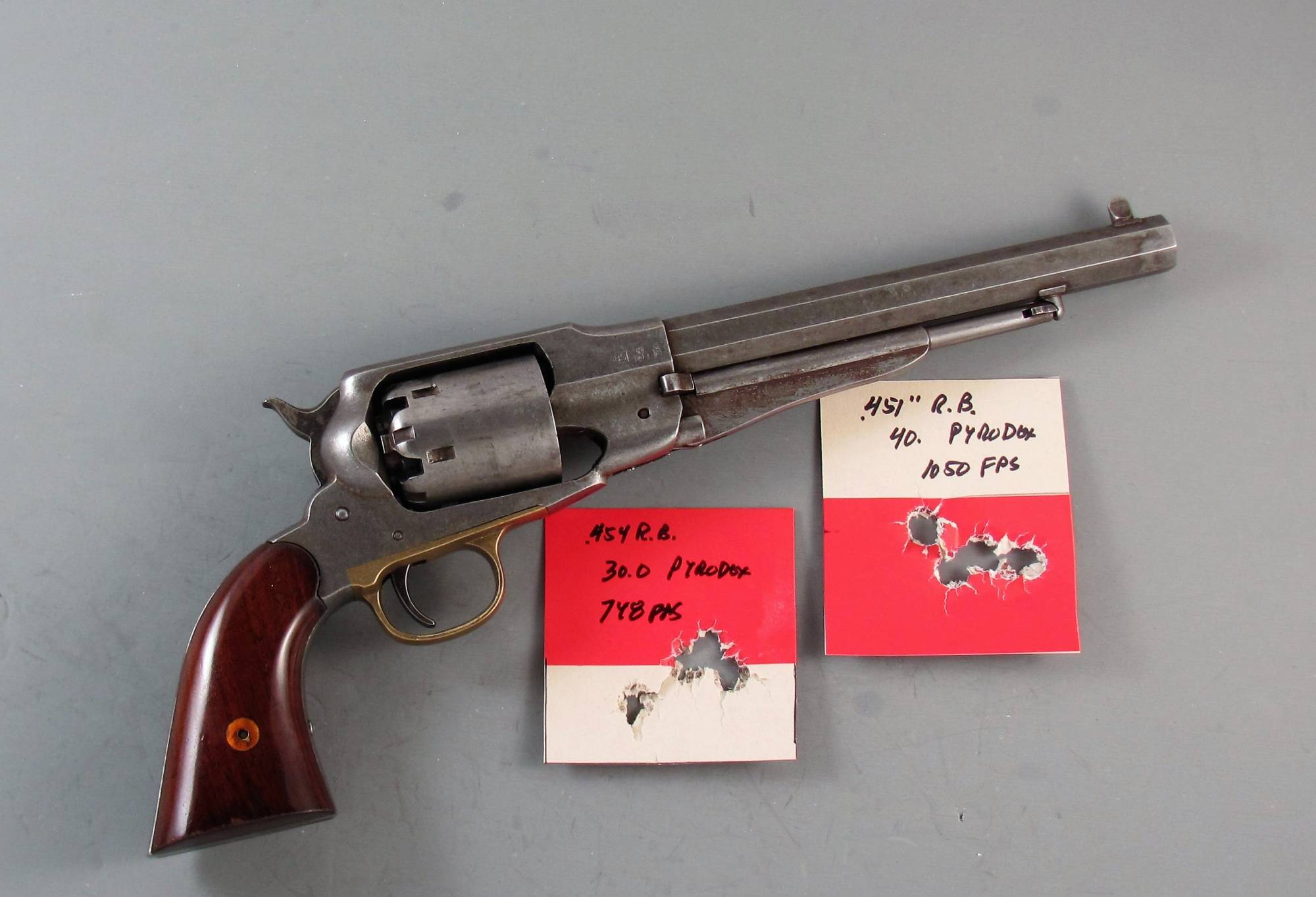

[image][image][image]
Thanks John! Beautiful guns. (nt)
