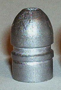

It started one day when I had nothing going on. Messing around in the shop I got to looking at the 480 Achilles Huffaker bullet.
I wondered, "How would it work if I sized it down and shot it in the .45 Colt?" Asking yourself questions is one thing but the answer was immediate. "WHY NOT TRY IT AND SEE?"

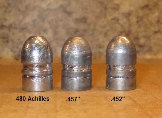

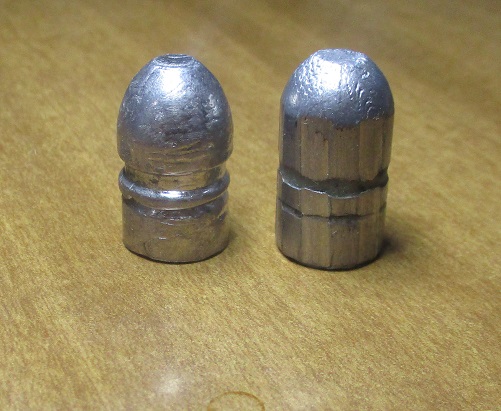

So I dug out my Lee push-through sizing dies and ran a few of the bullets through the .457" die, then switched and ran those through the .452" die. PERFECT!

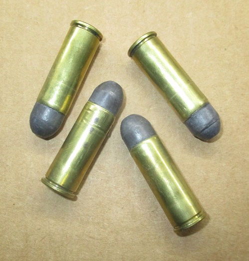

I loaded them into the .45 Colt cases with 6.0 gr. of Green Dot powder.

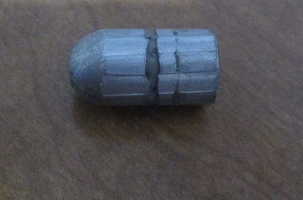

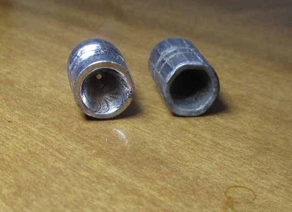

I set up a bunch of old towels and shop rags and fired one into them to see what the bullet looked like. I had about 18" of cloth which proved to be enough. The bullet came within 4" of exiting the cloth, hey, it stopped before exiting so all is OK.
