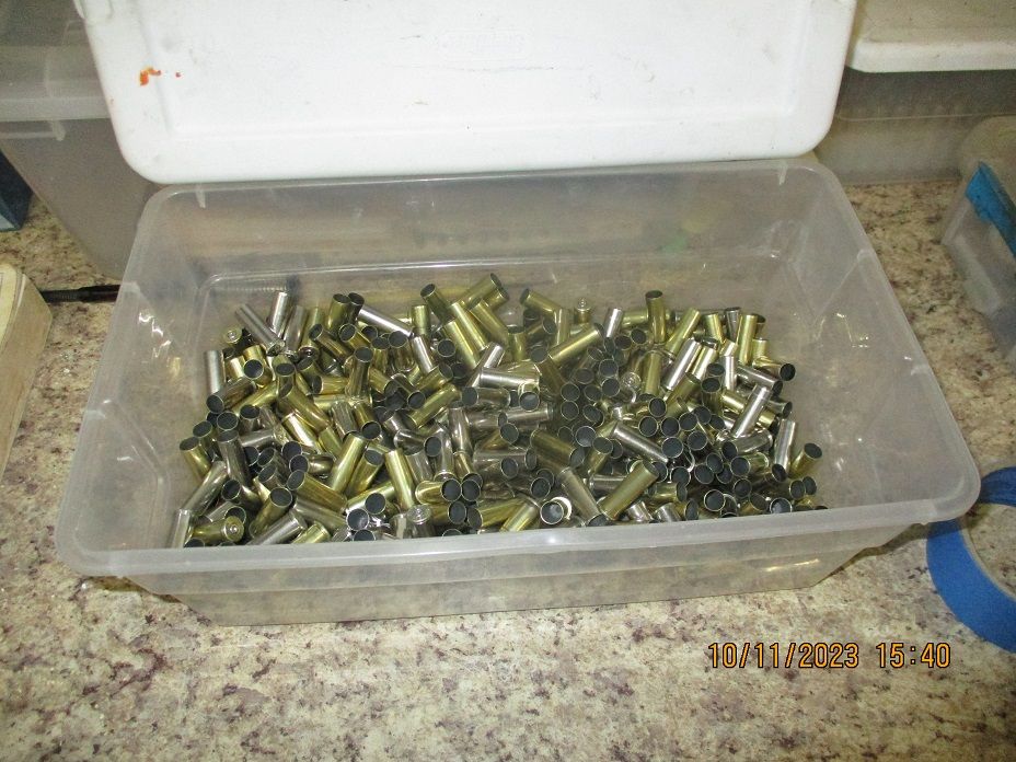

Got all the brass cleaned and am ready to start reloading it all!

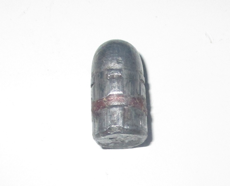

Some of the loads were light enough that I could see the bullet going to the target even though it was only 15 yards! One went in a slow rainbow arc, hit the cardboard backstop and bounced off. I walked to the target and picked up the bullet.
I pulled 3 of the bullets and found one loaded with 3 gr. of a dark flake powder I am sure is Bullseye. The other 2 had a fine grey powder and only 2.4 grains weight of it. Not sure what it was.
Anyway ..here is approximately 700 rounds ready to start the loading process.

Need to shoot up some odd-ball stuff myself.
I have them all sized and deprimed.
by JimT, Texas, Thursday, October 12, 2023, 12:11 (1127 days ago) @ Creeker
Neck expanding is next. Then I will prime them all.
by Creeker @, Hardwoods, Thursday, October 12, 2023, 20:24 (1127 days ago) @ JimT
I have a universal depriming die from RCBS I really like.
I now have them ready to load ...
by JimT, Texas, Thursday, October 12, 2023, 22:32 (1127 days ago) @ Creeker
sized, deprimed, neck expanded and primed.
I am planning on loading them with the 158 gr. SWC over 3 gr. of Bullseye.
by Creeker @, Hardwoods, Friday, October 13, 2023, 07:23 (1126 days ago) @ JimT
Shot that load a bunch only with a Magma Machine Cast RNFP. Being all out of Bullseye I now use Promo as a replacement.Which primer are you using?
I have CCI Small Pistol ... (nt)
by JimT, Texas, Friday, October 13, 2023, 07:52 (1126 days ago) @ Creeker
