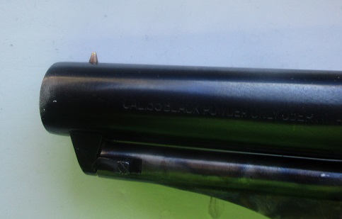

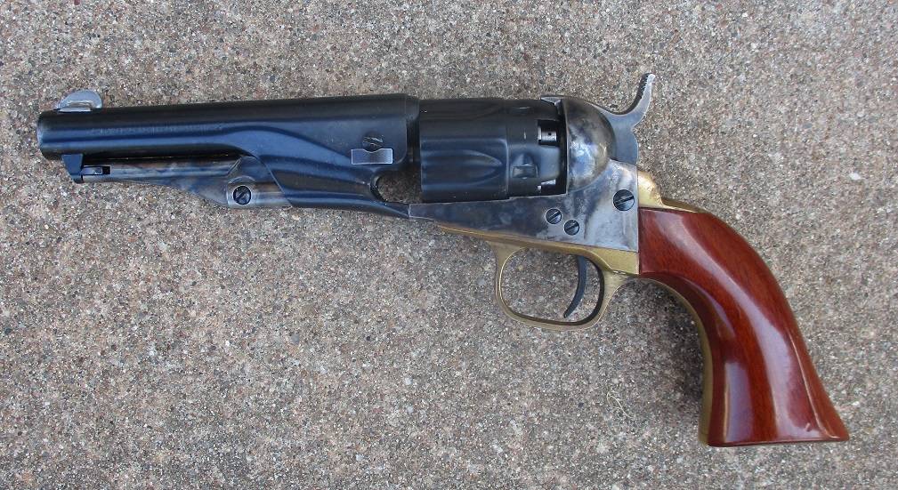

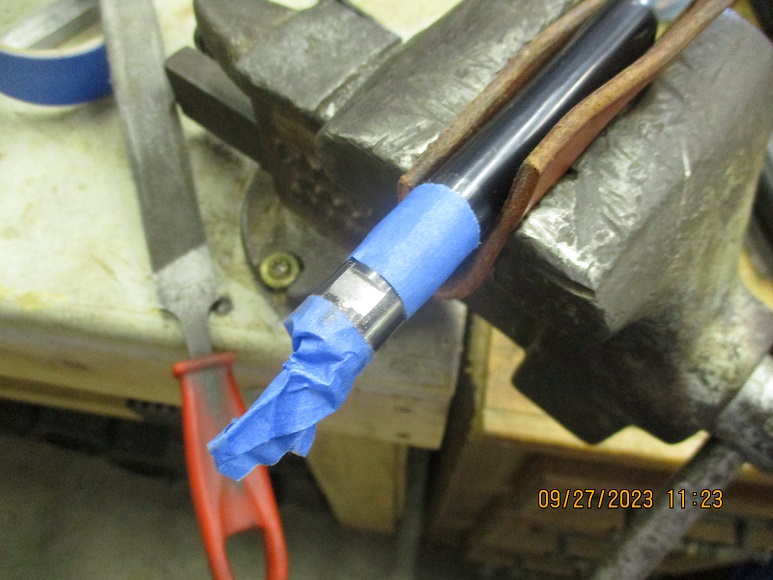

I love shooting the 1862 Police .36 but that little tiny bead on the front is ridiculous for old eyes and especially in bright sunlight. Plus it hit a foot high at 20 - 25 yards. It had to go!
So this morning I got out my tools and went to work.

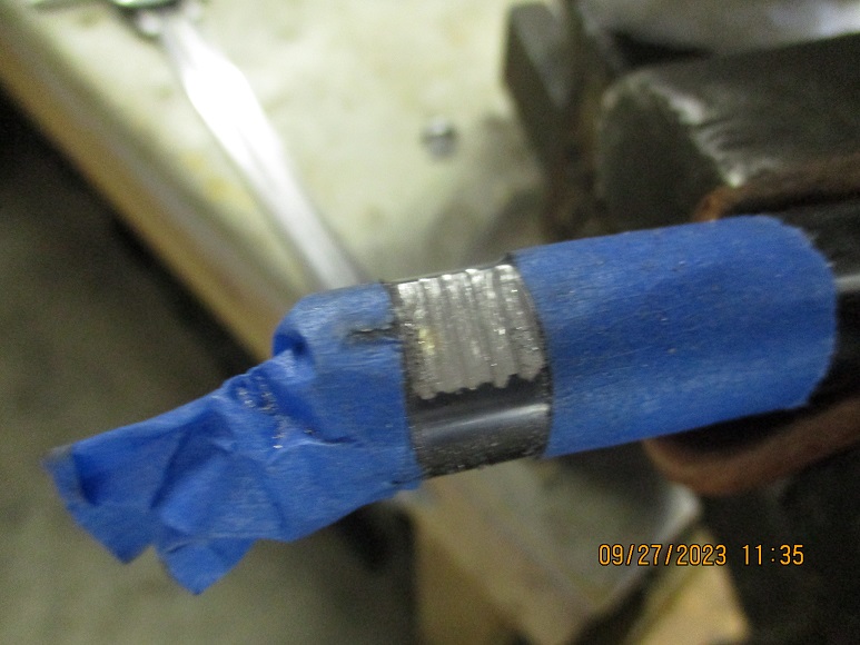

Cutting the dovetail ..

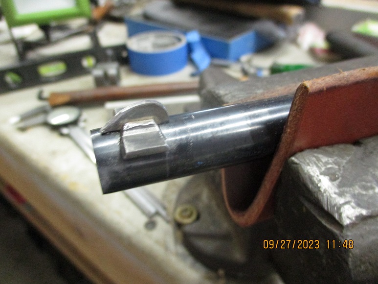

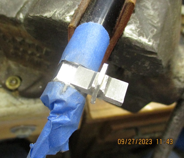

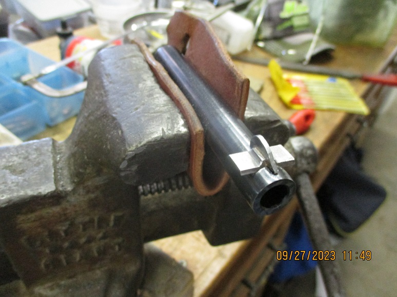

I had bought a Hawken sight blank from Dixie Gun Works. I shaped the sight somewhat before I started the dovetail

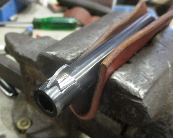

I cut the 'ears' off the sight and filed it down a little.

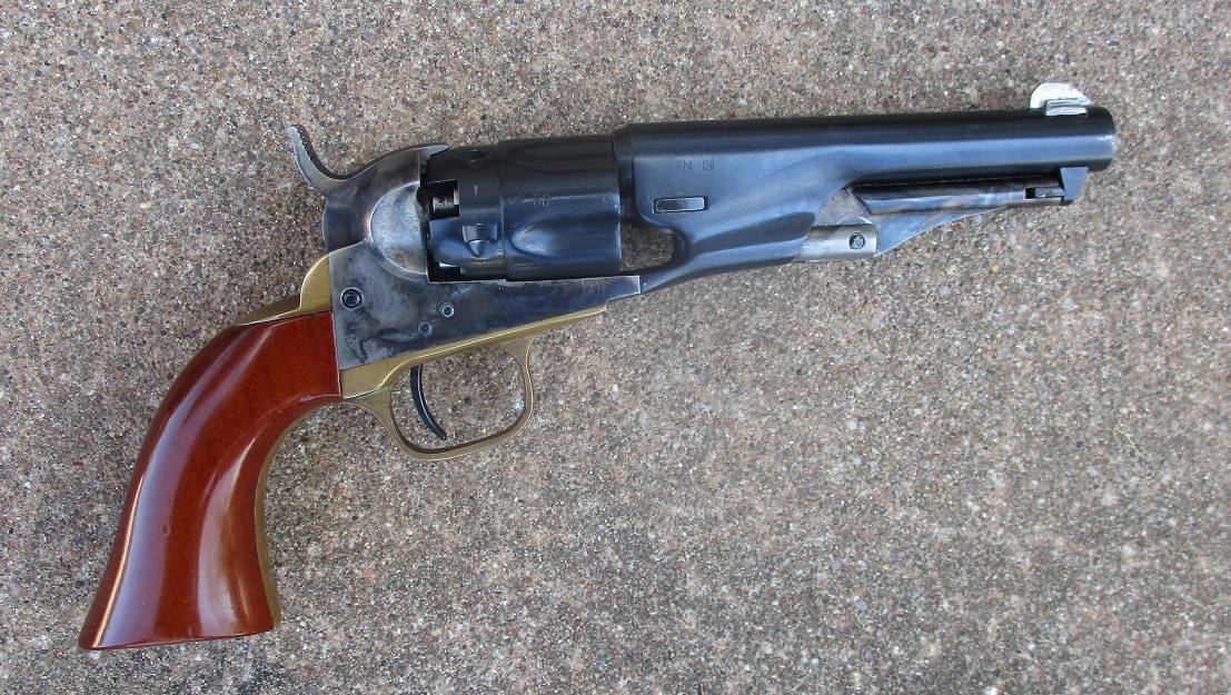

Now this is a sight I can see!
I will sight the gun in .. I am sure the sight is too tall .. shape and polish and blue it once it's sighted.

Your doveails are cut cleaner than mine! (nt)
by JimT, Texas, Wednesday, September 27, 2023, 12:37 (1141 days ago) @ JT
by JT, Wednesday, September 27, 2023, 12:51 (1141 days ago) @ JimT
BECAUSE MILT CUT 'EM!
Yessir. Lookin' good!

Looks great! That front sight is just what I’m looking for for a project I have. Is the blade a separate piece frame the base?
No. It's all together ...
by JimT, Texas, Wednesday, September 27, 2023, 16:32 (1140 days ago) @ Slow Hand
I don't see it on their website now ... but other than being all steel, it was the same as this sight.

Wider than the ones I am used to. But I cut mine by hand so it's not an issue. And it worked well for what I wanted.

Looks much more useable.
I have a few BP revolvers I need to do that to.
