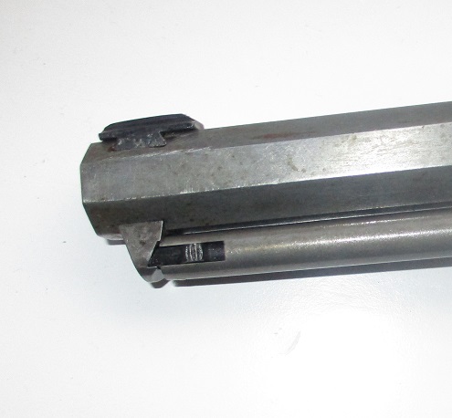

Went to the Range this morning to sight in the 1851 Navy. I had put a new front sight on it and needed to get it hitting close to point of aim. It was overcast and sprinkling but I braved the elements and got it mostly done.

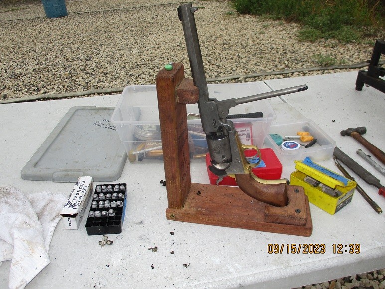

The front sight was quite high and I ended up doing a lot of filing to get the shots elevated where I needed them. I got it hitting just above POA with the heaviest loads.

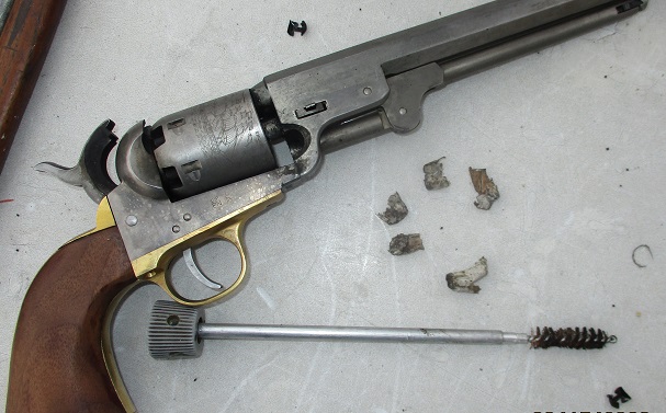

I cleaned the unburned paper out of the chambers after each firing. John Taffin has told me to buy a can of DUST OFF. Compressed air. Just use it to puff the paper out!

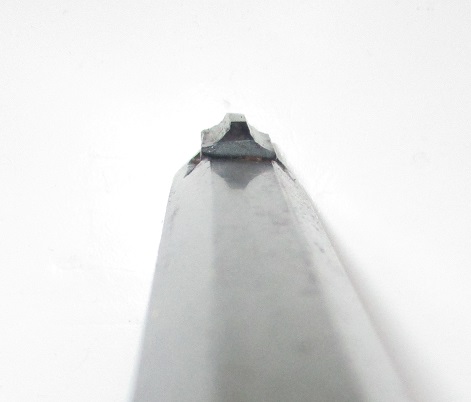

The front sight was taken down a long ways. I had to open the notch in the hammer but now I have a sight I can see!
