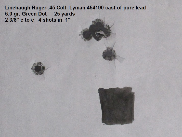

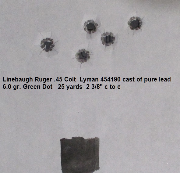

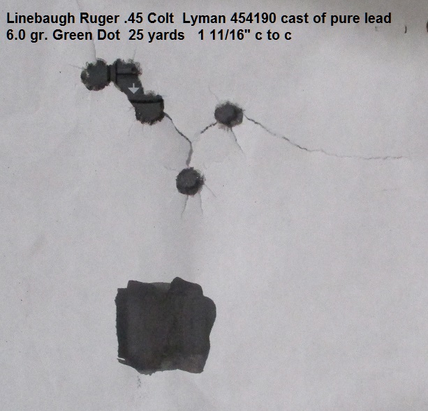

Testing a couple loads today. The first was with the old .45 Colt Lyman bullet 454190. These were cast of pure lead and sized .452" .. lubed with Paco's Apache Blue ... loaded with 6.0 gr. of Green Dot.

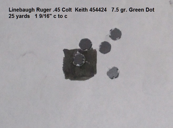

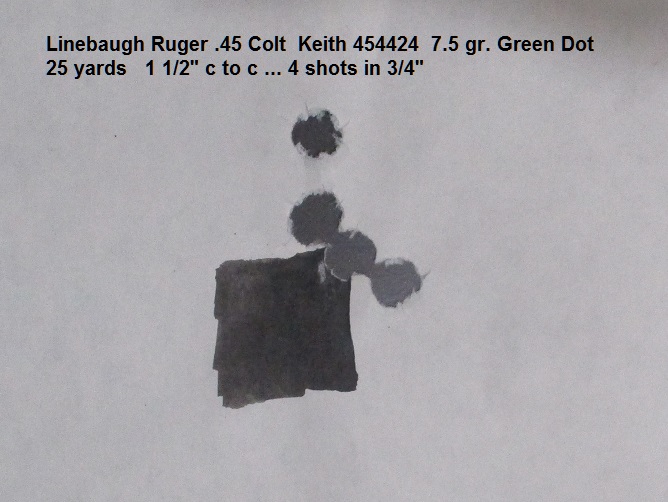

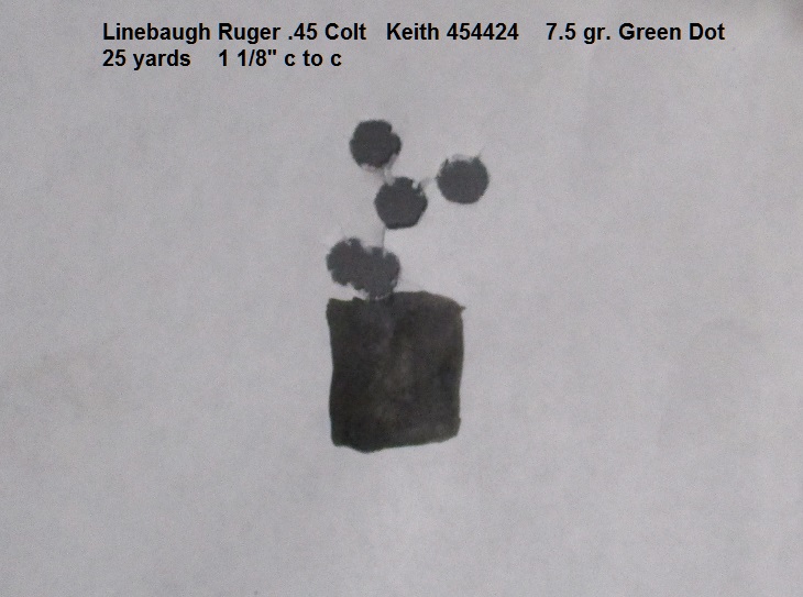

The other load was with the Keith SWC 454424 cast of hard alloy ... sized .452" and lubed with Paco's lube. These were loaded over 7.5 gr. of Green Dot.
![[image]](images/uploaded/2023090518071264f76e5096a1d.jpg)
![[image]](images/uploaded/2023090518072964f76e616e60c.jpg)
![[image]](images/uploaded/2023090518074764f76e7397f47.jpg)
The old Keith bullet has always been an accurate one for me, in .357 .. .44 or .45 ..

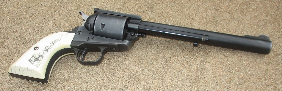

And the Linebaugh Ruger has always been an accurate pistol.
