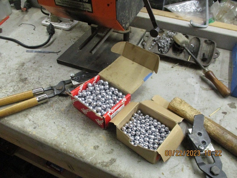

I cast some round balls for the cap n ball pistols
by JimT, Texas, Tuesday, August 22, 2023, 20:43 (1022 days ago)
last night and this morning. A bunch of .375" and .457" for the .36 and .44 pistols. To do that I had to drain the old Lyman lead pot because I had a hard alloy that I use for the centerfire handguns in it, and replace that with pure lead for the round balls.

Some of what I cast last night and early this morning.
