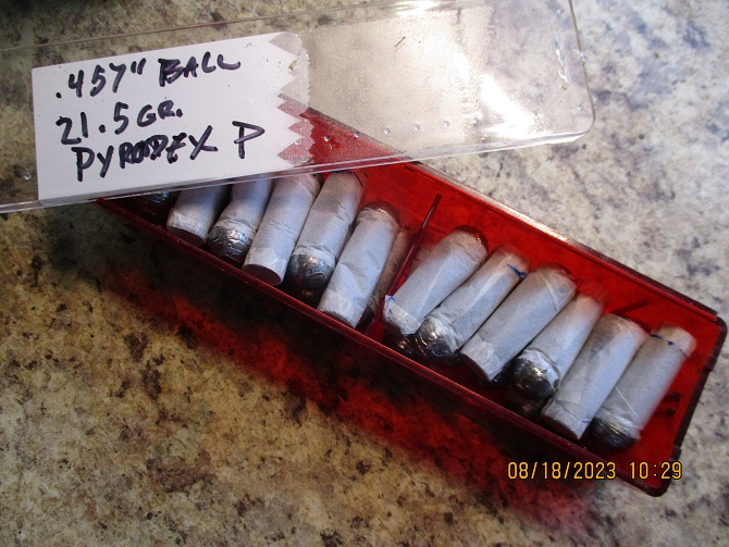

Loading Ammuniton
by JimT, Texas, Friday, August 18, 2023, 09:53 (1181 days ago)
for the 3rd Model Dragoon .44

Is the paper nitrated?
Using cigarette paper. Not as good as nitrated but works.
by JimT, Texas, Saturday, August 19, 2023, 04:01 (1180 days ago) @ A K Church
In shooting long strings I keep a rod with a 38 brush on it handy and once in awhile run it into the chambers to pull out any bits that have not combusted.
In the day, I used flash paper from the magic store.
by A K Church, Saturday, August 19, 2023, 17:53 (1180 days ago) @ JimT
ALWAYS burned up. My work functioned, but it was ugly as a cat's butt.

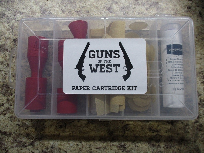

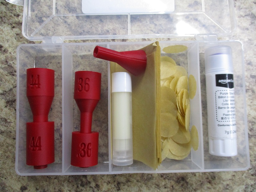

by Slow Hand ⌂ @, Indiana, Saturday, August 19, 2023, 18:22 (1180 days ago) @ JimT
Do you have a ‘kit’ for this or did you make your own form? I can definitely see them being handy for getting in more shooting.
Seems I’ve read About nitrating cigarette papers or tissue paper with stump dissolving crystals?
If I get into shooting this 1851 I might have to give the paper cartridges a try!
I bought a kit. It has both the .44 and the .36
by JimT, Texas, Saturday, August 19, 2023, 19:08 (1179 days ago) @ Slow Hand
by E Sisk, Friday, September 01, 2023, 23:46 (1166 days ago) @ JimT
I use these in my ROA's https://www.amazon.com/Graham-Beauty-Truewave-Regular-HC-56174/dp/B005YCCZXE/ref=sr_1_2... with a tapered dowel and glue stick. There used to be a U-tube vid before they deemed it banned knowledge.
