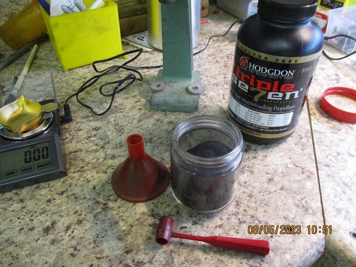

I am using Triple 7 for the 1851 Navy .36

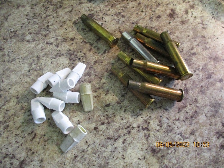

The charges will be weighed, put in the 30-30 cases and capped with a rubber eraser.

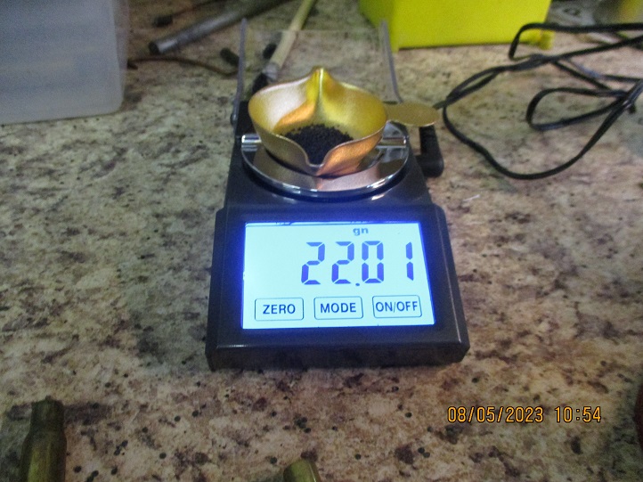

Weighing the powder charge.

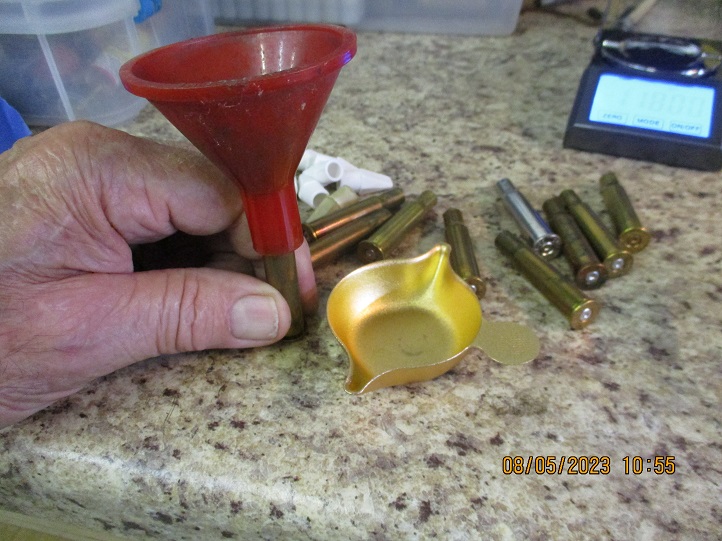

Dumping the charge in the cartridge.

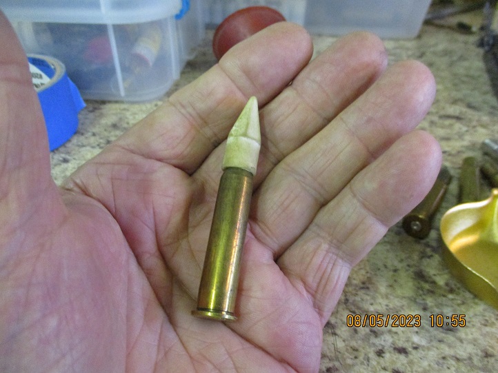

Capped with rubber eraser.

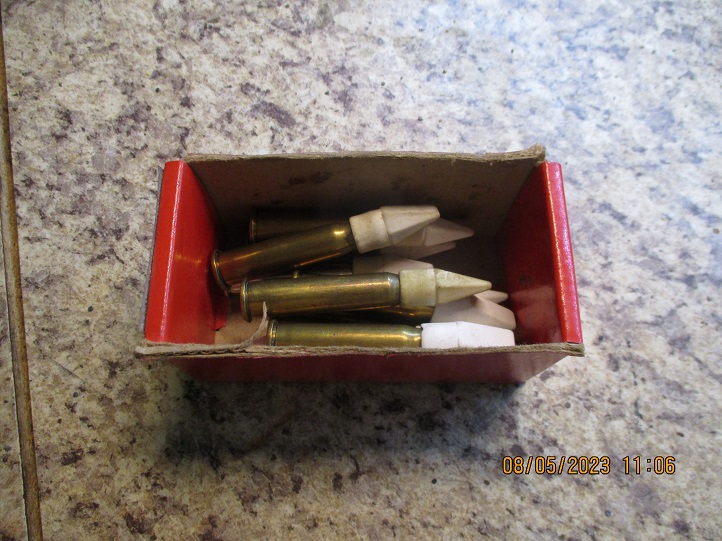

Ready for the Range.
The 30-30 case will hold 40 gr. of FFFg. If you are shooting a Dragoon or a Walker and need a larger charge you can use 308 or 30-06 cases.

sales, you should be able to pick up a bulk bag of those erasers pretty cheap.
AND!! Different colors for different loads!
