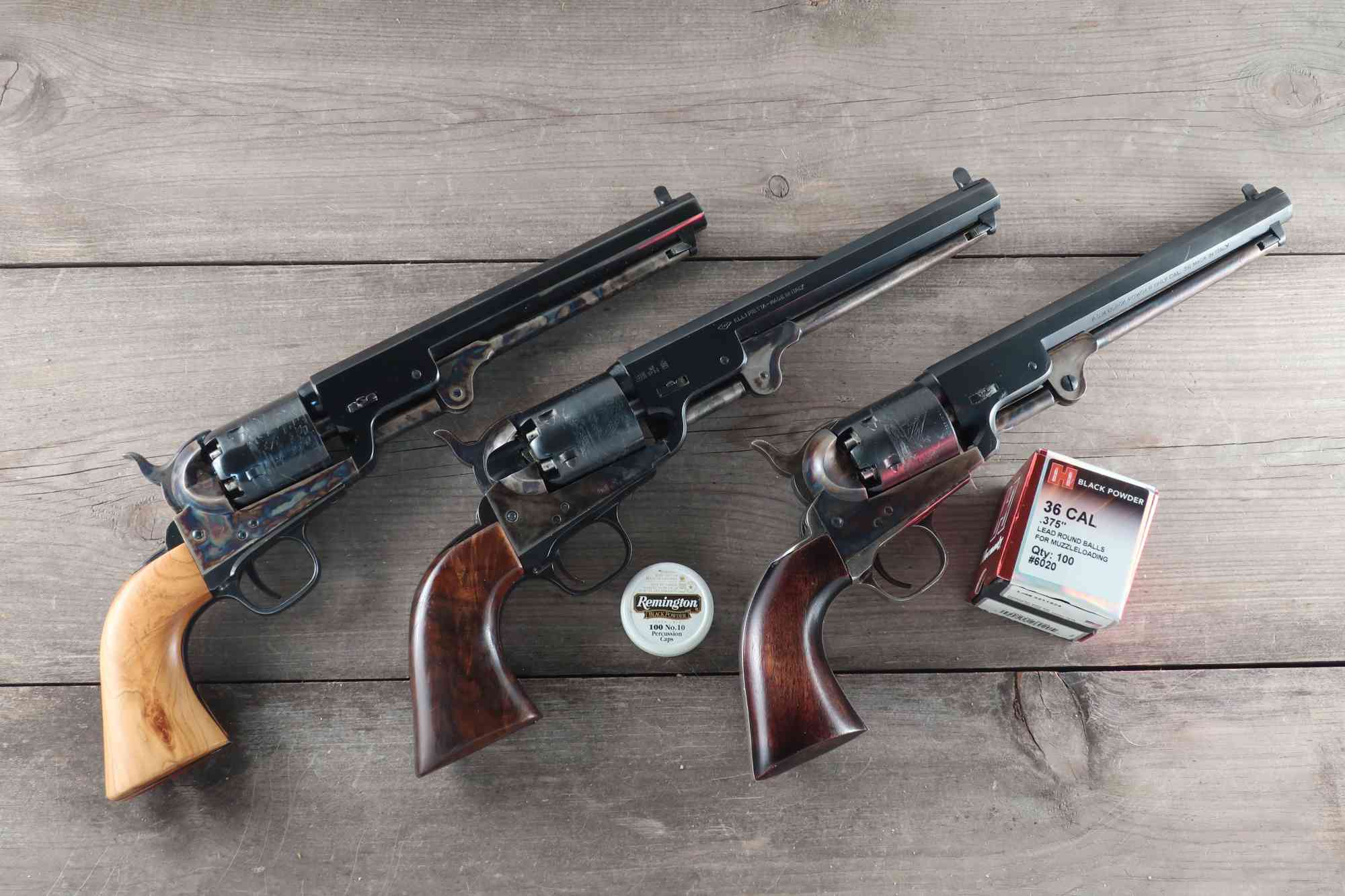

UBERTI, PIETTA, ASM
FAVORITE .36 LOAD
Picked up the ‘51 Navy last night
by Slow Hand ⌂ @, Indiana, Wednesday, August 02, 2023, 10:43 (1198 days ago) @ JT
I wish mine had a taller sight like your three do.
I don’t have any triple 7, but I have a couple kinds of black and sone pyrodex P
by JT, Wednesday, August 02, 2023, 11:36 (1198 days ago) @ Slow Hand
THOSE ARE REMINGTON FRONT SIGHTS INSTALLED BY MILT MORRISON FOR ME. NEED TO BE FILED IN FOR ELEVATION.
