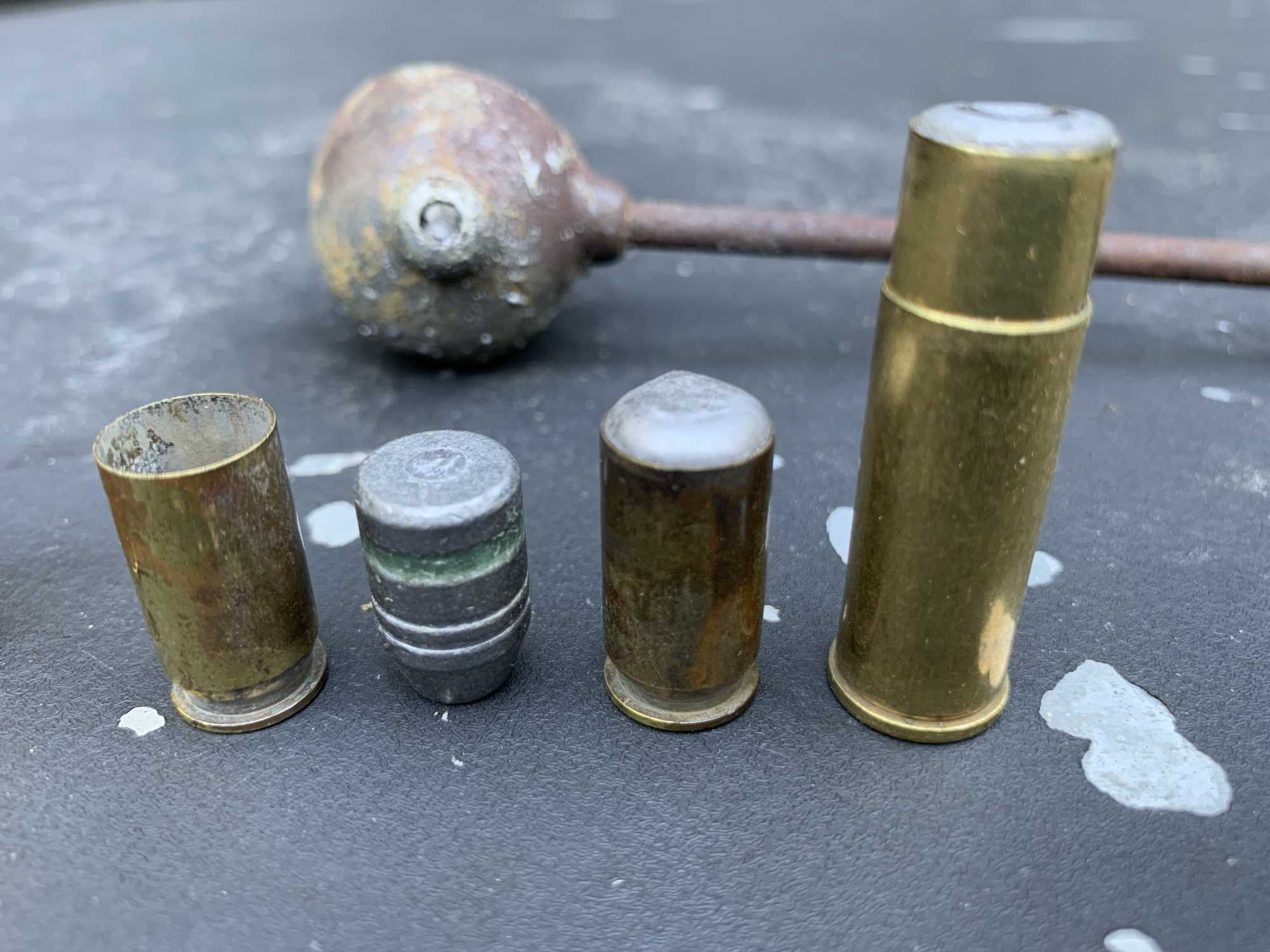

by E Sisk, Tuesday, June 27, 2023, 15:35 (1233 days ago) @ JimT
May have already posted this. I use small primer 45acp cases, pour 300 gr lead in and load in 480 Ruger cases. Round holes at 50 yards with two inch groups. [image]
