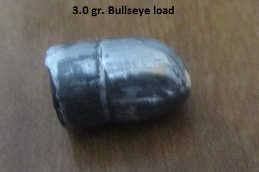

Not trusting the strength of the old H&R I used the Bear Creek 124 gr. round nose 9mm bullet sized .356". They will slide all the way into a case that is sized in the .38 S&W die. I slightly pinched the case mouth to keep the bullets from dropping onto the powder charge. Even with a heavy crimp you can spin the bullets in the cartridge.

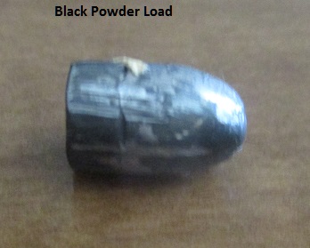

With the cartridges sized in the 9mm sizing die I loaded one with 12 grains of 3Fg Goex black powder. That is a completely full case, compressed.
The other case I loaded with 3.0 gr. of Bullseye.

With the cartridges sized in the .38 S&W sizing die I loaded one with 12 gr. of 3Fg Goex black powder. Again a completely full case, compressed.
The other case was loaded with 3.0 gr. of Bullseye.

12.0 gr. Goex Black Powder
case sized in the .38 S&W die penetrated .540" to the base of the bullet
case sized in 9mm die penetrated 1.07" and broke the rear side of the 2x4
3.0 gr. of Bullseye
case sized in the .38 S&W die penetrated 1.109" to the base of the bullet
case sized in the 9mm die penetrated 1.487" and would have exited if it had not turned sideways
