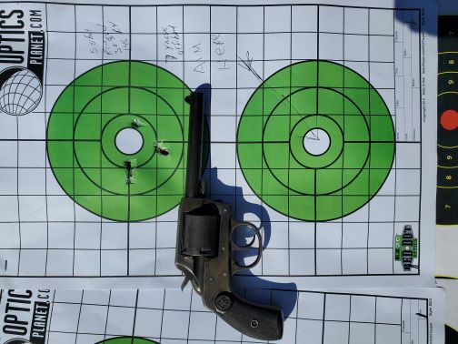

Here it was in action.
Remington 38 S&W 146 Gr. RN cartridges of recent manufacture.
7 yards offhand in double action mode. Had to aim at the bottom bullseye to hit the top one. These felt really powder puff powered, (the revolver has a .013-cylinder gap).
I backed up to 15 yards and shot a cylinder with 3 very old REM UMC 146 RN and 2 old Western Lubaloy 38 S&W 146s, and they strung up and down in to an 8-inch group. One thing I noticed was the Western Lubaloy 38 rounds felt more powerful than the Remington's.
Leading inside the barrel was non-existent after 10 shots, but the forcing cone was leaded to high heaven, I suppose from the bullet having to cram into a tight bore.
I need to make a new taller front sight. Why does one want to tinker with such things? The image below is resized to keep it from being so large. For some reason my method of resizing seems to stretch the image.
Bob

Bob, I suspect your gun, like mine, has the front sight pressed into a slot in the barrel. I found a piece of scrap banding was an exact fit in the slot. I cut a piece and filed it to shape and pressed it with a vise and some wood blocks, then filed it to the proper height. It's still in there and works fine, but of course mine is a .22.
Might give you a place to start. GOOD LUCK!

Yes, thanks for the tip. The front sight on this revolver is razor thin for sure. I saw a 32 version of this revolver at a gunshow today. The guy wanted 150 dollars. The dumbass in me looked it over and for a second or two I almost made an offer. Then reality set in and I came back to my senses and declined and moved on. Maybe because a nickel-plated Smith 32 hand ejector was calling my name a few tables down. I coon fingered it some and said to myself "Man this speaks volumes of quality over that US Revolver at home. Then the tightwad in my said "Naw, I have enough toys.........One project pistol is enough............Bob
