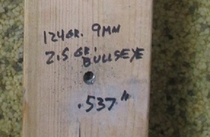

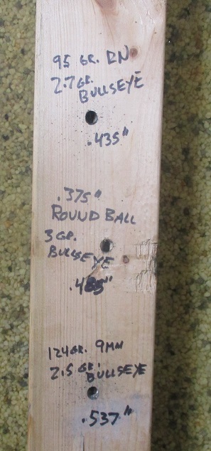

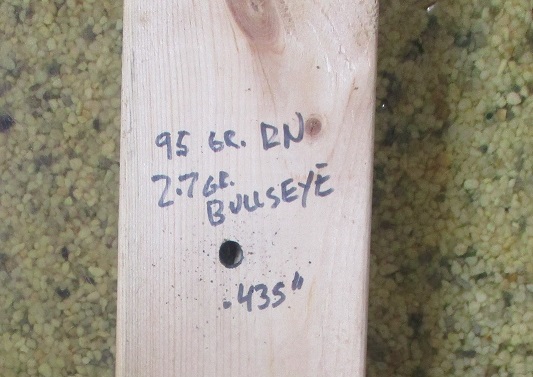

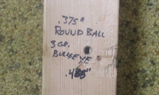

by JimT, Texas, Tuesday, March 14, 2023, 14:48 (1339 days ago) @ JimT
All fired into a 2x4 from about 16"
95 gr. cast RN .361" 2.7 gr. Bullseye .435" to base of the bullet.
.375 pure lead round ball 3.0 gr. Bullseye .485 to base of bullet
124 gr. cast 9mm bullet 2.5 gr. Bullseye .537" to base of bullet
2x4
