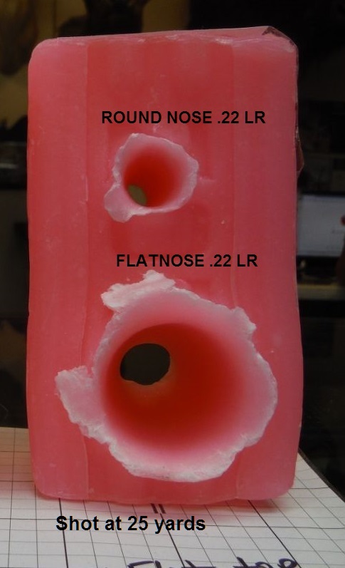

Shooting game with these has proven the effectiveness .. and some people report they do not tear up the meat as badly as hollowpoints. I have shot critters from squirrels up through 50 to 60 pound dogs and other varmints with them and found them to work very well. I know they will anchor a cat pretty fast.
Why would you want to modify the roundnose bullets? Because you can purchase 550 of them here in my area for $9.99 plus tax. Try buying some hollowpoints and see what you pay. A little work in the evening and you have a .22 hunting round that is more effective than a hollowpoint.

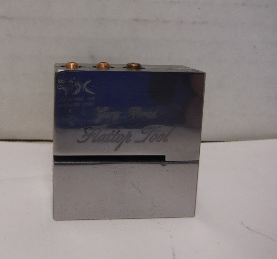

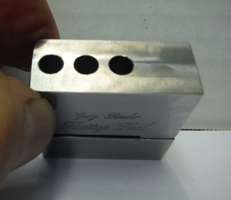

NOTE: THE SGB TOOL HAS NOT BEEN MADE OR SOLD FOR MANY YEARS NOW. BUT MY FRIEND GARY REEDER (www.reedercustomguns.com) IS MAKING AND SELLING A "FLATTOP TOOL" THAT IS THE SAME THING. WITH HIS TOOL YOU CAN DO 3 CARTRIDGES AT A TIME. IT IS A QUALITY TOOL! AND THE CONCEPT BEHIND THE TOOL IS STILL THE SAME AND STILL VALID, EVEN AT TODAY'S PRICES FOR AMMUNITION.

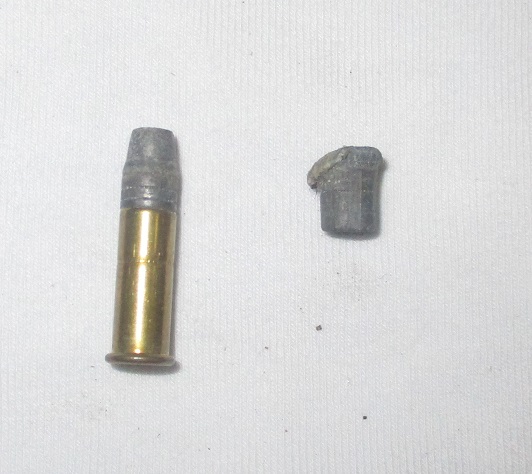

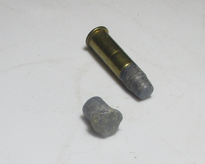

I shot a Javelina that was in our yard with a standard velocity .22 LR I had flat nosed. It dropped just after I shot it. The bullet went through the lungs and stopped under the hide on the opposite side. I cut the bullet out and still have it 30-some years later.
