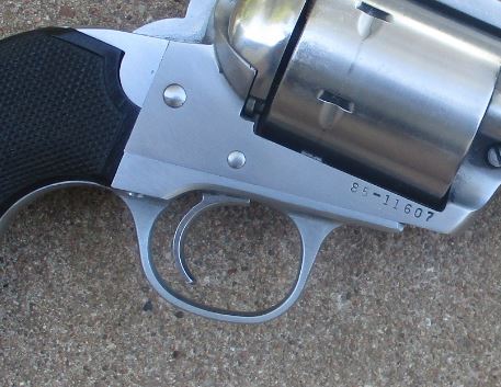

On my Ruger .45 Colt I straightened the trigger.
by JimT, Texas, Friday, February 10, 2023, 19:07 (1370 days ago) @ Don Sikes
I held the sear end in a large pair of vicegrips to act as a heat sink. I heated the middle part of the trigger till I could just see a bit of color. I laid it on the anvil and tapped it lightly with a small hammer .. tapping on the back of the trigger .. til it was where I wanted it. I never worried about re-heating or anything. It's been like this for 30 years or so and has never given any trouble.
I have straightened quite a few. I tried just bending one without heating it and broke it. Ever since I have heated them.
EDIT: Actually now that I think about it, it was in the middle 1980's when I did that! Closer to 40 years.

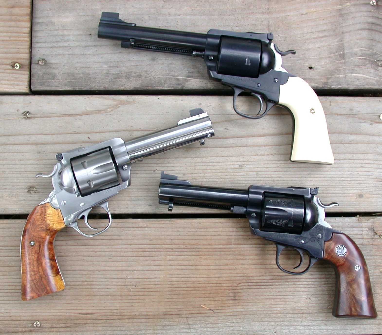

by JimT, Texas, Friday, February 10, 2023, 22:36 (1370 days ago) @ JT
Gary did this one for me. The first I had was done by Jim Stroh on my .475 Linebaugh. The trigger coming forward as the gun went into recoil would catch my trigger finger between the trigger and the trigger guard and take a chunk out of my finger. With the trigger not coming forward but staying in the rear like a shotgun trigger it stopped all that.
Gary doesn't do them anymore because the clearances are so small that if some dirt or grime builds up the trigger can quit functioning and tie up the gun. The .41 has never given me an issue that way and I have not been kind to it.

by JT, Saturday, February 11, 2023, 09:20 (1370 days ago) @ JimT
He did nice work. And that stops the trigger from biting!
by JimT, Texas, Saturday, February 11, 2023, 09:24 (1370 days ago) @ JT
