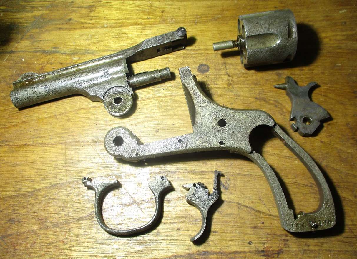

I am about at the point to start putting it back together. There are pits in some of the chambers but there is no problem getting the shells in and out. There is pitting on one side of the rifling at the muzzle and we will see if that hurts accuracy much. ;-)
The big problem is the cylinder hand. It's toast. I am gonna need to find another one. It's a little bitty thing maybe an inch and a quarter long. If you have something similar in your junk drawer I would be interested.

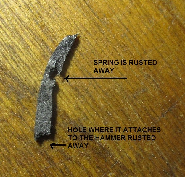

I ordered a cylinder hand. Now I need a mainspring! (nm)

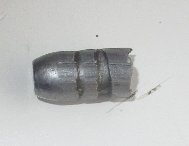

I shoved a .358" bullet through the bore ... the .38 S&W is supposed to be .361" but this gun ain't that big.
"36 Navy" round ball
by Paul ⌂, Saturday, February 11, 2023, 07:36 (1348 days ago) @ JimT
in a 38 S$W case should make a dandy projectile in that. It'd probably shave a bit of a ring and leave plenty of lead to engrave on the rifling. I find your project quite fascinating!
I pushed 2 of them through the barrel ... no problem.
by JimT, Texas, Saturday, February 11, 2023, 07:48 (1348 days ago) @ Paul
I have shot them in the .38 Special. They turn into an elongated bullet sorta round on both ends. :-)

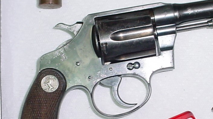

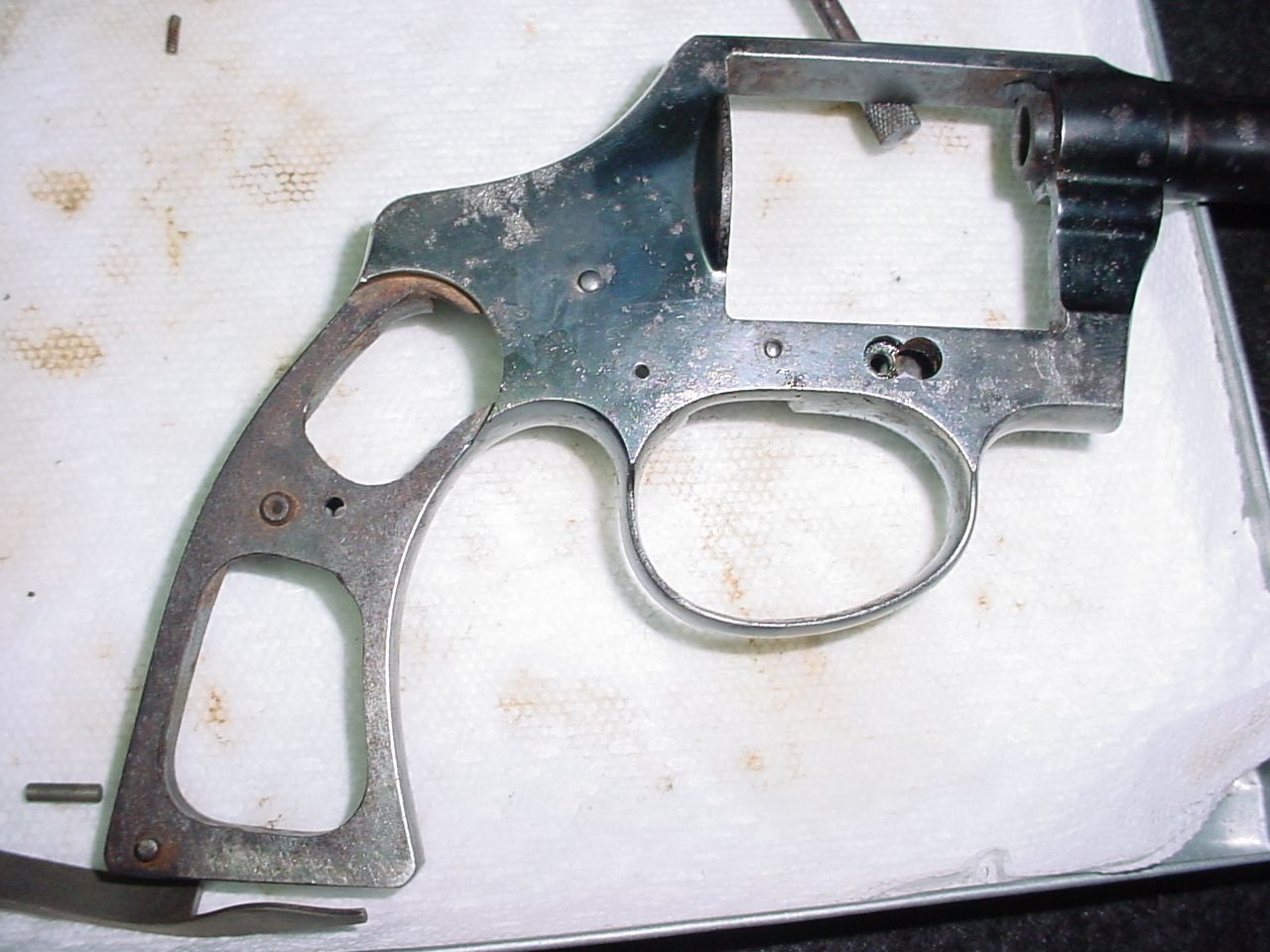

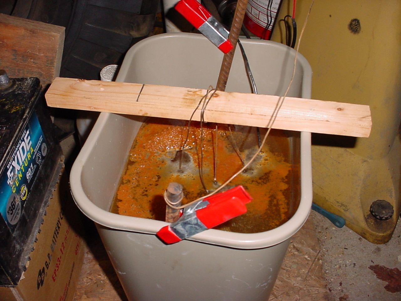

I learned about the electrolysis process when cleaning some Winchester 1886 barrels that were picked up at a garage sale and it worked very well on them. Then a dozen years ago I picked up a pitted, rusty Police Positive Special in 32/20 that got put through the electrolysis rust removal method very successfully.[image][image][image]
