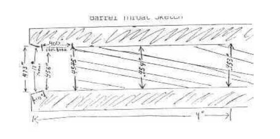

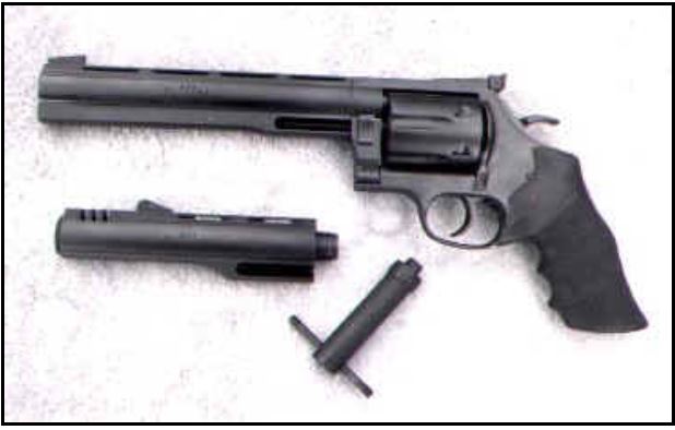

Back in the '80's I burned the barrel throat in one of my revolvers to the point that it was starting to cut the cylinder face and the top strap. I asked my Dad what he thought we could do about it. After studying it he decided on a radical approach. We screwed the barrel out of the gun, set it back 2 threads to clean it up, and re-cut the forcing cone. In addition Dad reamed a special throat into the barrel which consisted of an 11 degree forcing cone and a freebored section approximately 1 caliber long.

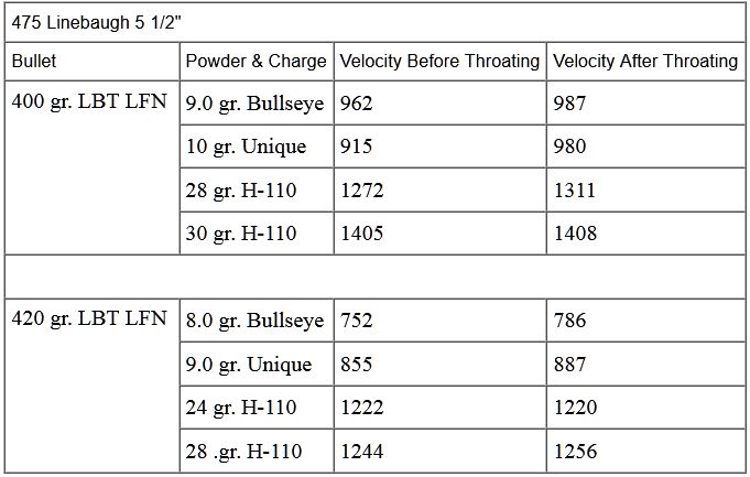

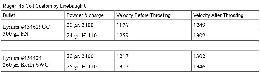

We hoped the freebored barrel would help stop forcing cone erosion. Whether it does or not I have never determined.(NOTE ADDED:20-some years later I am still shooting this gun with erosion problems.) What we did find was that accuracy increased a lot. I fired 25 5-shot groups at 25 yards with 3 different bullet diameters. Where the gun originally was particular to the bullet diameter, now it shot well with any of these sizes:
.450" diameter averaged 2.3"
.452" diameter averaged 1.8"
.454" diameter averaged 1.99"
The velocity increased also. Statistical analysis confirmed this to be due to the throating.
