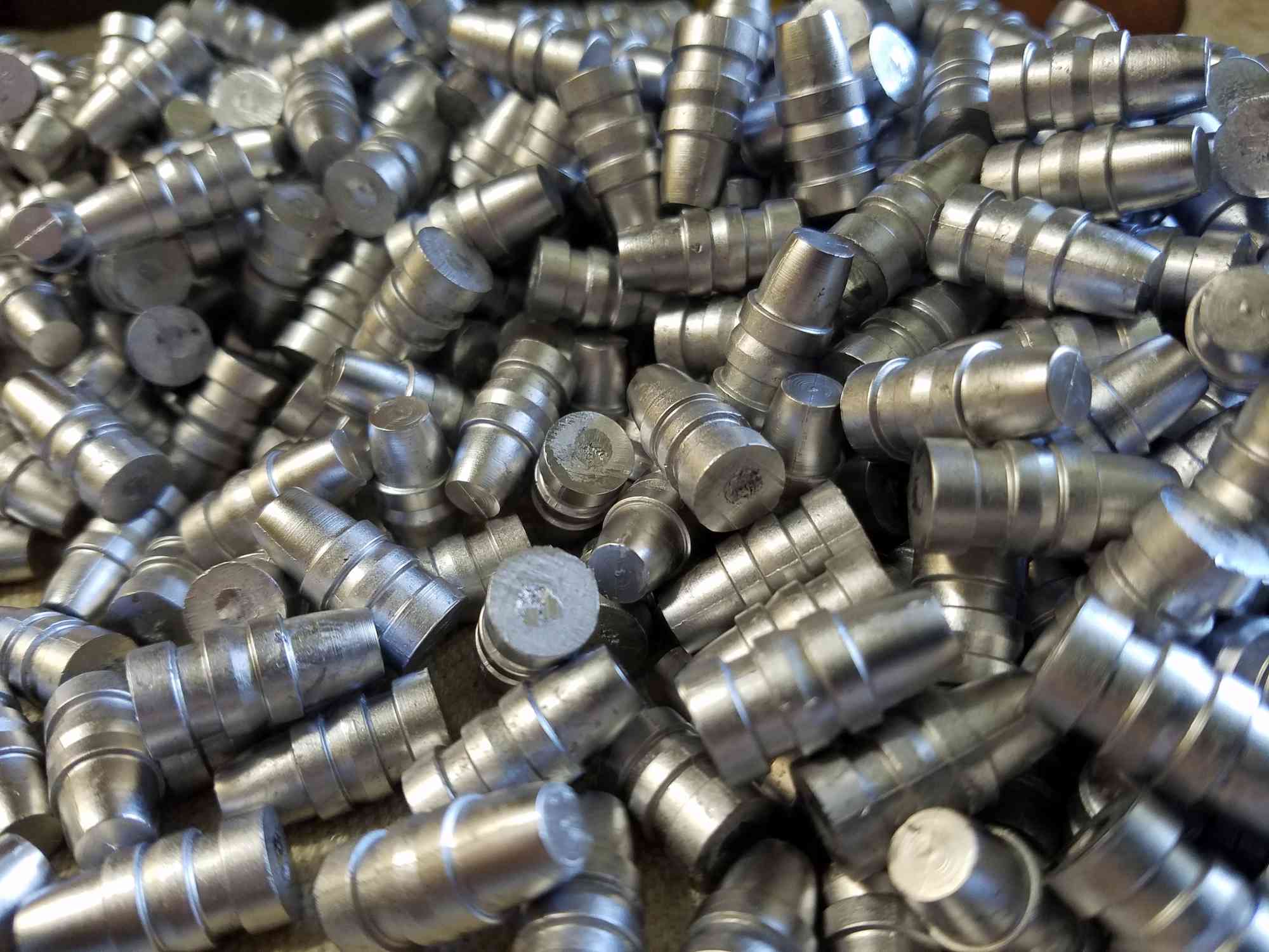

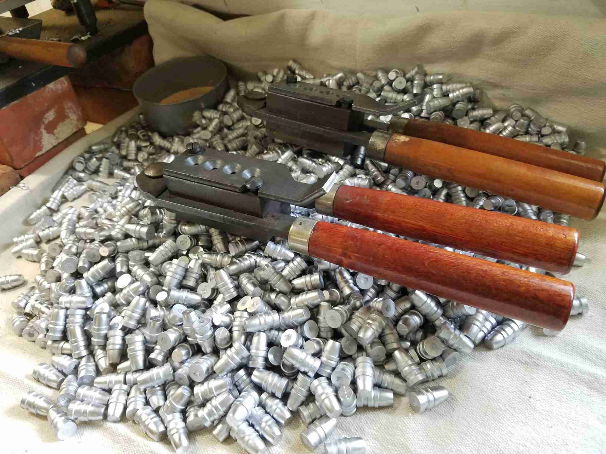

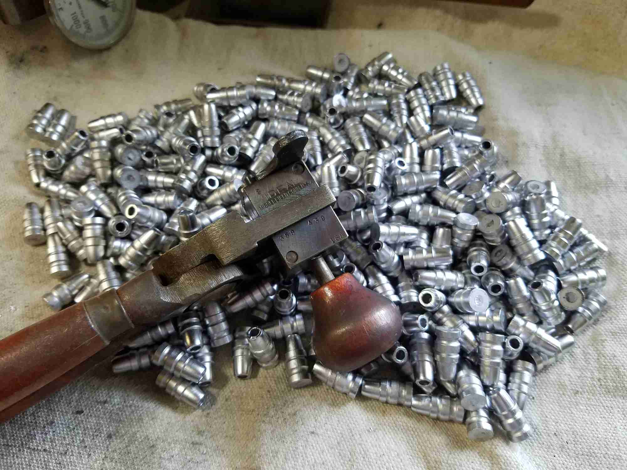

Over the years people have copied, changed and sometimes boogered up the original design. The original Keith design has a wide, flat-bottomed grease groove, the "sides" of the grease groove being slightly beveled. And it had 3 bands of equal width: front, middle and rear. It also had a beveled crimp groove. It has a fairly long nose. And it is a flat-base, plain-base bullet. The RCBS .45 KT mold and their .44 KT mold come very close to the originals, at least in the copies I have. The Lyman design was changed to a rounded grease groove, which, while it works OK (and I have shot a lot of them) was not original. Is it important? Probably not... unless you are a nostalgic old codger like me. I have used the Lyman design.. still have a mold in fact... and it is a good accurate bullet.
#358429 [image]
#429421 [image]
#454424 [image]
