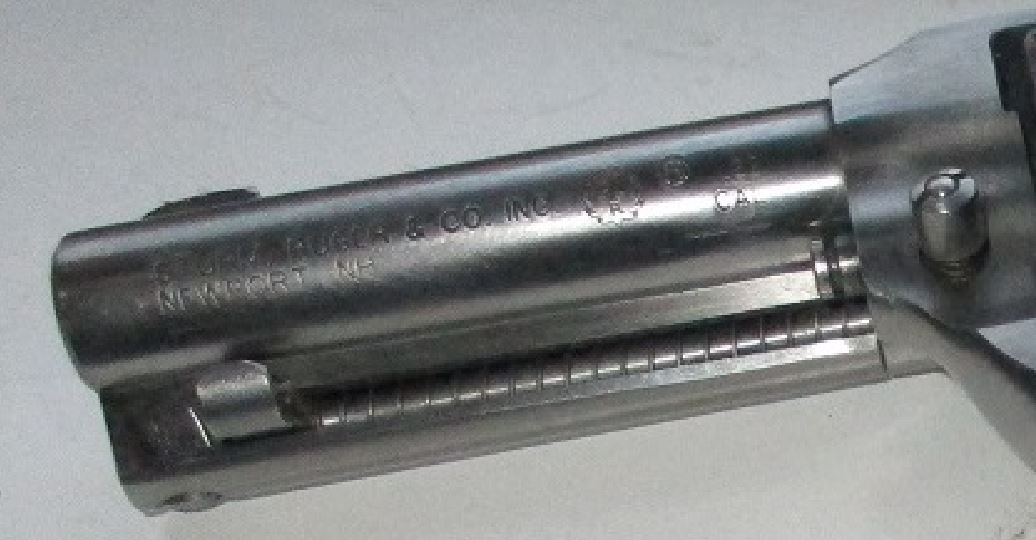

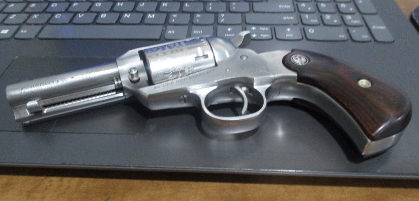

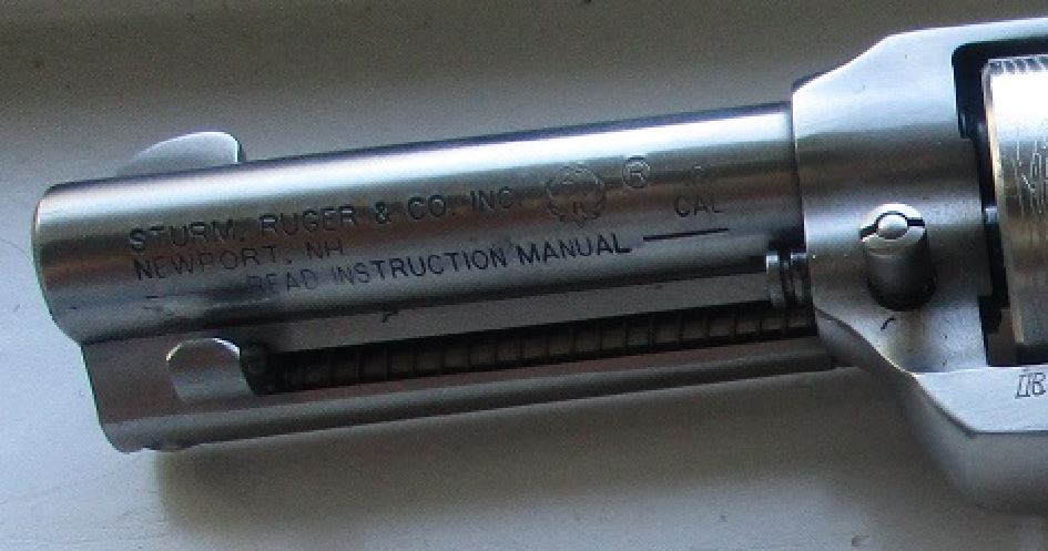

I like the little Bearcat Shopkeeper EXCEPT for the verbiage under the barrel. I have never liked the lawyer-inspired READ THE MANUAL stamped on the Rugers.
So I pulled the ejector rod and housing off the Bearcat and using a fine jewelers file I drawfiled the stamping until I had removed it. I tried to "round" it so I did not make a noticeable "flat" on the barrel. Once I had the lettering gone I used 220 grit sandpaper to smooth it out, followed by 600 grit to polish it. Then I finished up with the Dremel Tool polisher.
Looks a lot better to me ...

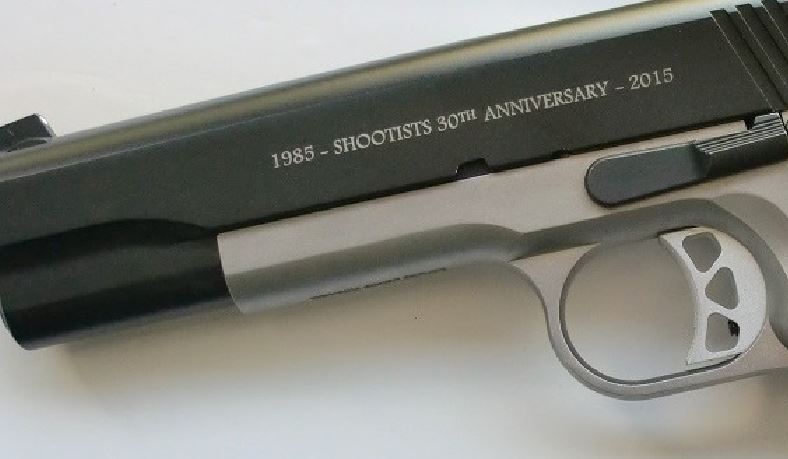

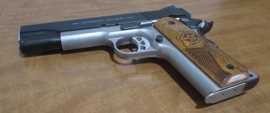

I removed it from the Ruger SR1911 also ..
That was easier to remove. Most of it came off using a typewriter eraser. Fine sandpaper finished it. To make the finish match the bead-blasted stainless I laid some 220 grit sandpaper on the polished area and tapped it with a light plastic mallet. It took a little while but eventually I got it close.

by Paul ⌂, Monday, December 12, 2022, 18:44 (1430 days ago) @ JimT
I really like how that SR1911 turned out. I've got Ted Adamovich's now, thanks to Matt O. I've been contemplating what it'd take to do that bit of improvement, wouldn't have thought of a typewriter eraser as a starting point.
