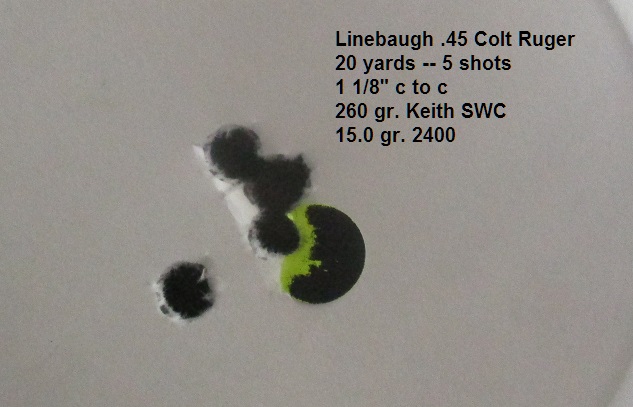

Testing different bullet diameters with the "new" gun proved to be a revelation also. Starting with .454" diameter bullets I worked down. When I got to .450", groups really began to tighten. Using the Keith #454424 semi-wadcutter over 7.5 grains of Unique produced several groups under 1-inch, center to center, for five shots at 25 yards. One group had four of the five in 3/8-inch. Over a period of several months groups were fired at ranges from 25 to 200 yards. With the help of a friend, 4x4 foot sheets of plywood were placed at 150 and 200 yards. We painted an aiming point on each, then settled down to see what could be done. Groups were fired then the long walk to measure each, tape over the holes, go back and shoot some more. My best groups at 200 yards were around 12 inches for five shots. For some reason those "worst" groups were not recorded.

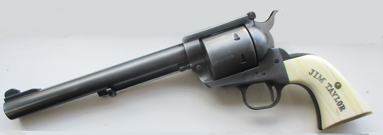

A few months ago I decided to pretty up the Ruger. It was worn looking, the bluing was gone from most of the frame and the grip frame had shiny spots. I sent it off the be black chromed and the grip frame to be re-anodized. I had never seen black chrome but it sounded interesting. When it came back the finish was more like Parkerizing than chrome, rather dull in appearance. I liked it. I do not know what the wearing properties will be but time, as always, will tell. I have a stainless steel gun it did not work on. The corners wore off immediately. Black chrome is an oxide of chrome that goes on real thin and cannot be built up. Apparently it was designed originally for use in optical systems and is being used today in solar and laser applications. The people in the plating business felt it would not wear any better than bluing. So far I have put over 500 rounds through the gun and it shows no signs of wear. The salesman from the company asked that I not use their name in this article. It seems the boss is anti-gun and does not want guns coming into his business. The salesman got in trouble for taking my order! I was relieved to get the gun back in good order and that they did a good job on it. It pays to inquire before shipping a gun off.

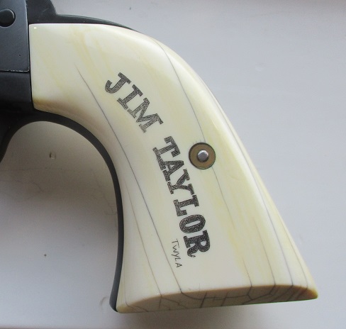

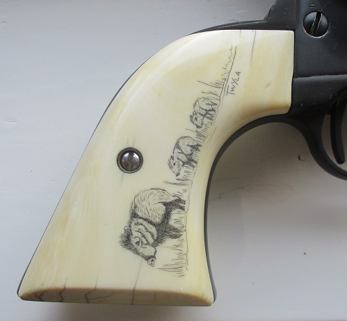

The black gun looked real fine to me but I felt it needed some special grips. A man here in my town, Sam Bass, made a set out of ivory. He also makes custom knives and does scrimshaw. He had been teaching my wife to scrimshaw so I asked her to do the grips. My name is on the left grip panel with the same style of lettering used on a gun belonging to Pat Garrett. The right side wears a javelina to commemorate my Record Book trophy taken with this gun.
I read once that everyone should have at least one gun customized to his own specifications. I’m happy with this one and maybe partly because it is a 45 Colt.
This is a recent photo .. the black chrome finish still looks pretty good after all these years!

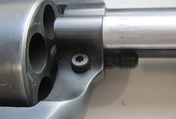

Cylinder pin retaining screw

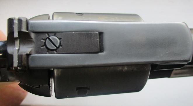

I "flat-topped" this gun with a horse-shoe file and then a lot of hand polishing.

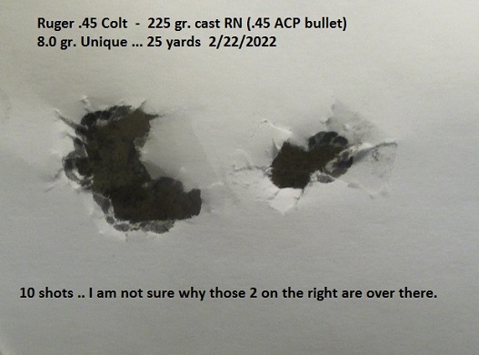

RECENT TARGETS - the old gun will still shoot.

when I take that .45 out, my loads are either the Keith SWC and 8 gr. of Unique or the 255 gr. roundnose and 7 gr. of 700X.
