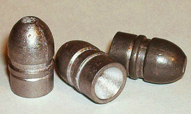

mould with a gas check cut ? Cast soft and sans the check it should work as a conical. Might not fit into cut in frame to allow to rotate under rammer but off gun loading always works. .44 special case is about right volume for a 250 to 300 gr.
Reason I suggest a gas check design is the pseudo heel allows you to load it plumb. Hard to get a conical in there straight without heel or tapered diameter.
My walker is currently loaded with a .44 special case of pyrodex p and a r.c.b.s. version of the lyman maxiball muzzleloading conical. No grease in grooves but a smear of soy wax over the top.
No .. the only gascheck mold I have is for the 30-30 ...
by JimT, Texas, Wednesday, November 16, 2022, 07:54 (1456 days ago) @ RayLee
but my Dad's home-made "round nose" works pretty well. And I have a mold I am thinking of trying ... casts a 290 gr. for the 480 Achilles ... Heel bullet .. hollow base ... Heel is .452" and if I can size down the nose ......
